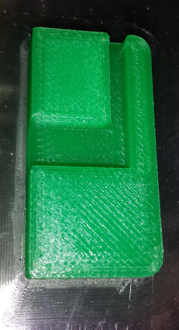

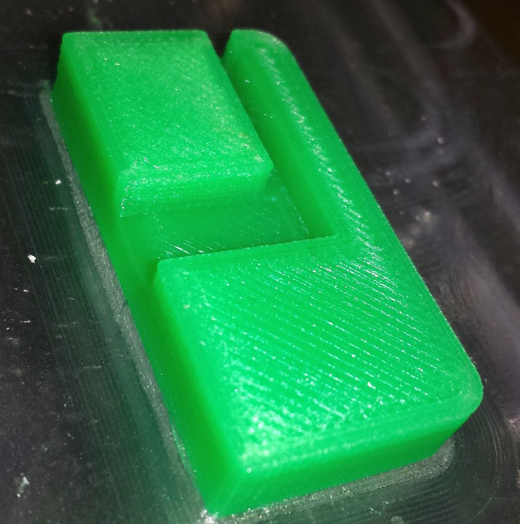

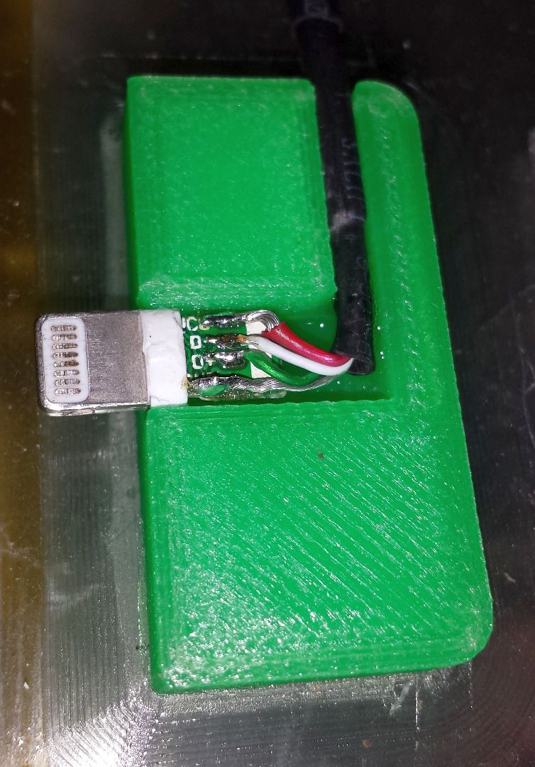

The model is printed up to the height where otherwise the "lid" would be glued on - in this case 7.5mm.

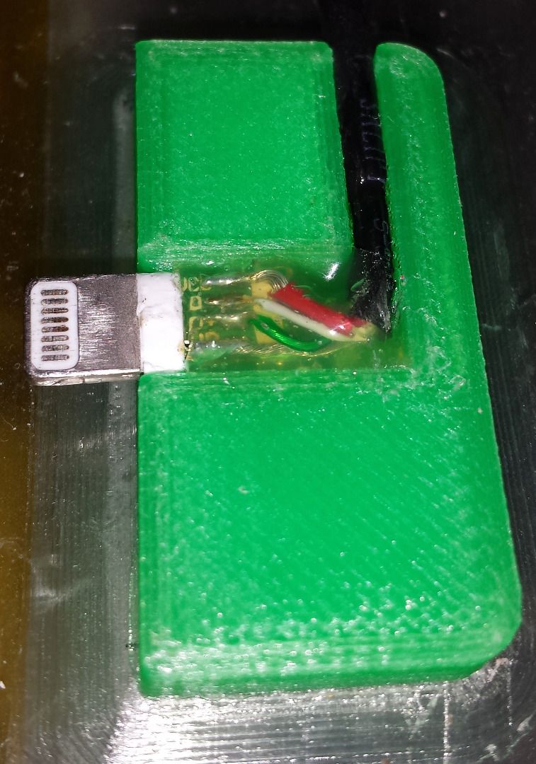

The cable and plug are put in place and secured first with a bit of glue then covered with hotglue.
Once all is set and the hotglue cold it is time to check that nothing sticks out of the surface too far!
Now the print is started again with a start height of 7.5mm, which means it would start printing in mid air if we had removed the block.

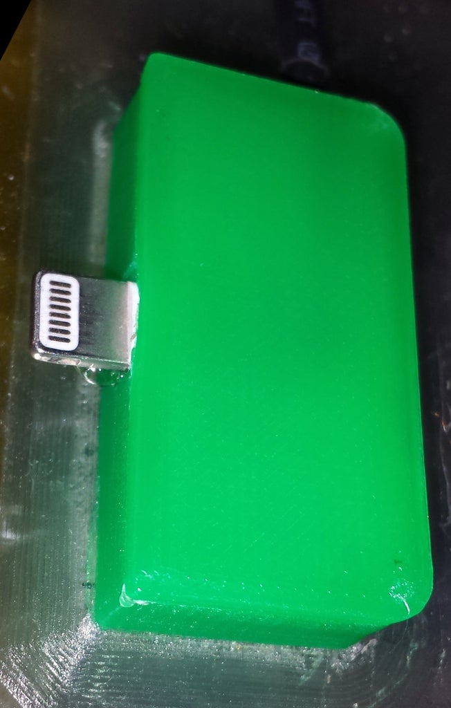

As you can see in the below videos the Nylon does not really stick to the plastic remains of the USB plug but that was to be expected, ABS would have been the better choice here.
As this piece is not too wide the gap will be fully covered three layers later.
You can see in the above videos the hotglue is partially messing with the surface quality, I removed the hot glue that was pushed around by the nozzle during the print.
This was due to the fact that the hot Nylon partially started to boil the hotglue underneath.
Nylon is not very forgiving, so you might want to do your first tests with some easier material like ABS or PLA.

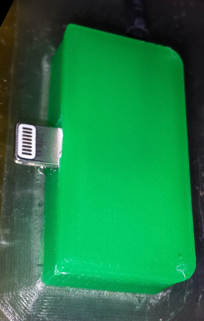

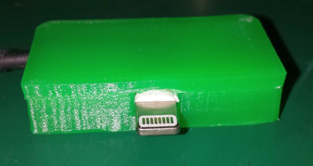

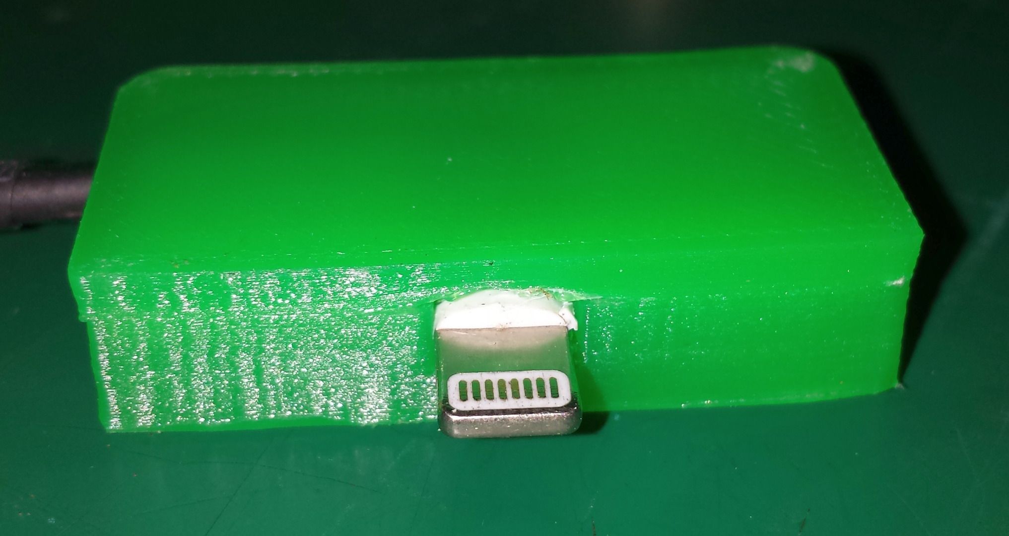

The finnished "heavy duty" plug, like a solid piece of Nylon:
And after cleaning up the brim:
You can see the cable coming out on the left of the image with a piece of heat shrink tube to give some added kink resistance.

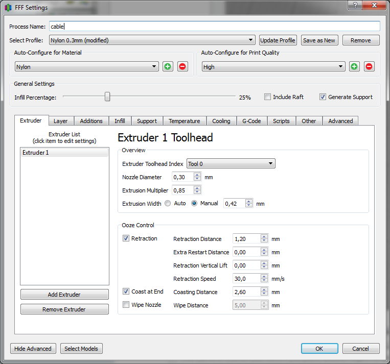

To give a useful example I will show you some screenshots of the Simplify3D software that regulate this.

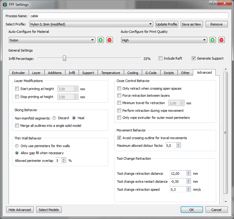

As you can see in the above image, there is a setting for the start height as well as the ending height of a print in the Advanced tab under "Layer Modifications".
If you tick "Start printing at height" and set a value, the print will ignore everything in the model below this value.
This means you have to have something under the new print with exactly that height as otherwise the print will start in mid air - and at least for my the filament won't stick to thin air ;)
If you tick "Stop printing at height" and set a value, the print will stop once the layer corresponding to this height is printed.
Please keep in mind that in some cases you actually should calculate this value properly!
Very bad example to keep it simple to understand:
You want to stop at 5mm but use 0.3mm layer heights for the print (same for the start layer as this has to be included in the calculation).
This would mean you had to stop at 16.666666.... layers - impossible.
So you calculate 16 X 0.3 and get 4.8mm - you either have to stop here or at 5.1mm height as you won't be able to print different layer heights!
The same goes for the start height of the next part of the print - you use the same value as for the stop height!

Note the little tab at the bottom, "Select models" !?
If you click another window pops open where you can select which model of your print uses these settings.
The selection can sometimes be confusing so it is best to double check in the preview that really the right model part use the right settings and not that all is printed with the same.
There is a good help in the form of a website available if you click on it that explains further settings on how the models are printed.
Things like layer by layer or a specific number of layer on one model before using different settings on the other - here the nozzle clearance is very important!
