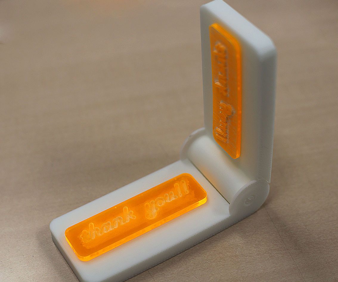

Introduction: Emboss Case
I made a box to put embosses I made last time.
