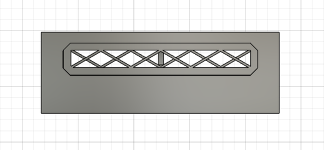

Step 4: Creating the Bridge Walkway + Truss Design Testing
By combining measurements and data from steps 3 and 4, the final walkway and supporting for the bridge was designed and modelled.
The design consisted of truss supporting structures along the edges of a rectangular prism formed by multiple beams. A portion of the final truss assembly that will be used for the bridge was tested under the same load that was applied to the beams in step 4. The truss assembly achieved a better deflection to length ratio than the 200mm x 300mm x 20000mm beam while using much less material in the process. This is due to the fact that the truss' allow the concentrated forces from the load to be more evenly distributed throughout the entirety of the structure.
The fact that this truss system takes much less material to construct while providing a great amount of strength will allow the cost of the bridge to be lowered without compromising its structural integrity. Screenshots 3, 4, and 5 include pictures of the walkway, its cross-section with the integrated truss design, and a schematic with some measurements to aid in the recreation of the walkway. The walkway also has arcs on its base to improve its load bearing capacity, as well as reducing the amount of material needed to construct it.

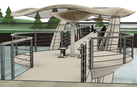

Step 5: Modelling the Supports of the Bridge (And Rendering!)
For this bridge, I decided to use a combination of pile and cable supports. The main purpose of the piles at the base of the bridge is to effectively distribute applied loads from the bridge surface towards the ground. The use of wire supports reduces the need for an excessive amount of piles, which increases the aesthetic appeal, as well as reducing the disruption to the surrounding environment and substrate of the pond it is constructed in.
A video was provided for the modelling process of my supports. I decided to use a simple "2-pile" support with a truss like structure in between the 2 beams for added stability.
The cable supports will be attached from an arch directly to the bridge's walkway. However, instead of having the arch fully above the bridge, it will also be mainly extended below the bridge in order to reduce its obstruction to the view of the surrounding nature area. The cable and arch design I am implementing will more apparent in the later stages when I put all the components of the bridge together.
A video was also provided to show how I produced the rendered images of my support designs. Note that the video only shows the steps for in-canvas renderings, which is a good way to get an insight of how your final product will look like rendered, a video detailing how to produce final renderings is included in the last step.

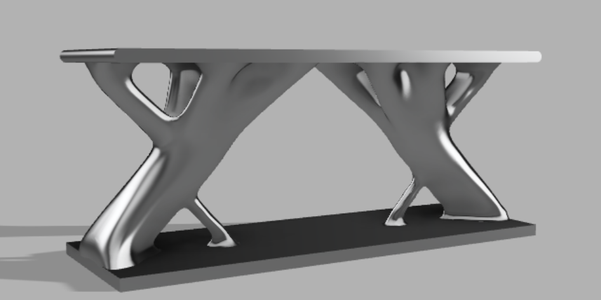

Step 6: Generative Design
I used generative design in order to design the benches/seating area's present on the bridge. Seating is important since it allows for space where people can socialize and enjoy nature simultaneously. I am utilizing generative design in order to minimize the materials used, as well as potentially maximizing the aesthetic appeal of the benches. Common uses for generative design include the automotive and aerospace sectors with the aim of cutting down the number of different parts requires to construct parts.
A general overview of how generative design works is as follows:
  • A designer or engineer creates a simple representation of the part while defining guidelines such as material, size, weight, force, cost, etc.
  • The computer program considers the aforementioned "rules" and generates many potential design solutions in a relatively short amount of time (much more than we can ever imagine!)
  • It is important to note that the more limitations/restrictions that you put on the generated designs, the more predictable they will be
  • A design is then chosen that best suits the intended purpose and meets the architect's or engineer's expectations
A video was provided giving a more detailed step-by-step guide to utilizing generative design in Fusion360 for creating the bench. The file for the bench is also provided below.

Step 8: The Completed Bridge Model: Putting It All Together + Form Modelling
In addition to the support systems, I had also designed, modelled and implemented railing to ensure safety of pedestrians, bridge outlooks for pedestrians to relax and enjoy the surrounding nature, and covers above the outlooks so that people can still enjoy the scenery during inclement weather conditions such as rain and snow.
A video is included of my design process for the entirety of the bridge, aspects of my design that ended up not being used or being changed/modified were also included in the video to emphasize the complexity of the design and modelling phase of any project, in the real-world or on Fusion360, and how my vision of my final project evolved as I; went deeper through my modelling process. Further videos are also included to show more detailed steps of more complex aspects of my bridge design, such as form modelling.

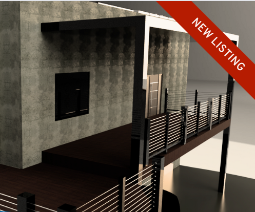

Step 9: Modelling the Surrounding Area
In order to give a better representation about how the bridge will be able to be incorporated into a community, I decided to challenge myself and design the surround landscape, buildings, and scenery (and you can too!).
I first started with the design and creation of a few bungalows to represent the community of focus situated in North Algona Wilberforce. I then added the forested area on the opposing side consisting of evergreen trees, as those are the most dominant tree type making up the abundance of Canada's forests. Hills were also created through the use of form modelling within the forested area. A river was then added below the bridge as well. The final Fusion360 file is attached below, which includes the completed bridge and the surrounding modelled scenery/landscape. A short video that shows the process of creating a final rendering is included along with the final rendering
