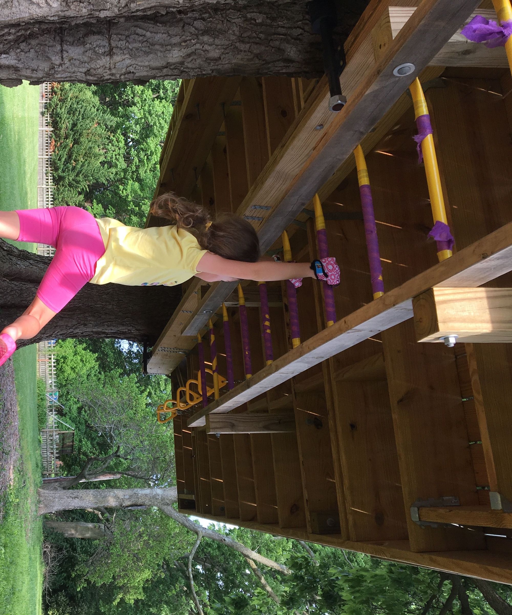

Perhaps my favorite part of the treehouse is the loft net. The net functions to prevent people from falling off the loft, provide additional sleeping (and napping) space, and allow visual access between the first floor and the loft. It’s also super comfortable! I ordered a custom size cargo net from treehousesupplies.com for less than $200. The size of my opening was 8’ x 4’ (give or take one or two inches), and I ordered an 8’x4’ net, knowing the net would stretch and sag. If anything, the net sags a bit too much (it’s too big), but installing a smaller net would have been quite difficult. I installed eye bolts around the perimeter of the opening – one eye bolt for each grommet in the net, and used a carabineer to attach each grommet in the net to the corresponding eye bolt. The most heavy-duty carabineers were positioned in the corners, and generally evenly distributed around the rest of the net. A challenge when installing the eye bolts was that the grommets were not evenly spaced around the perimeter of the net. To overcome this, I installed the corner eye-bolts first, then saw where the other grommets were positioned, and marked and drilled holes for the remaining eye bolts. Getting in and out of the net wasn’t too easy, especially after it started to sag, so I installed handles (left over pieces of the conduit) between ceiling rafters, which are actually quite helpful. The net is a favorite place for sleepovers, naps, and reading, and it’s strong enough to support the four of us with ease.
The back deck of the treehouse sits between large limbs of each tree and couldn’t be more perfect for a hammock. Another way to relax and enjoy being in the trees.
I also felt that the underside of the treehouse was under-utilized and needed some love. Wanting my kids to be able to get some exercise when playing outside, I built a set of monkey bars and attached them to the joists. I used leftover lumber for each side of the bars, and used leftover 4x4 posts and hardware to secure the monkey bars to the joists. I also drilled extra holes in the 4x4 posts to make the height (and slope) of the monkey adjustable. A tree stump makes a nice stool for the little ones to access the monkey bars.
