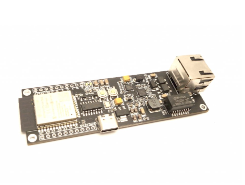

This is a short tutorial on basic test project for Esp32-Stick development boards(POE-P, POE-A, ETH). The basic idea of this project is to create a program that is going to blink a LED and starts pinging google.com.
  • Esp32-Stick development boards(POE-P, POE-A, ETH) (here)
  • ethernet cable (here)
Step 1: Connecting
Esp32-Stick development boards have one user LED build inside of them and connected to GPIO2 so we don't have to connect external LED. Thanks to that all that we're left with is to connect USB-C and Ethernet cable to their dedicated ports on one side and on the other to PC and we're done with connecting.
