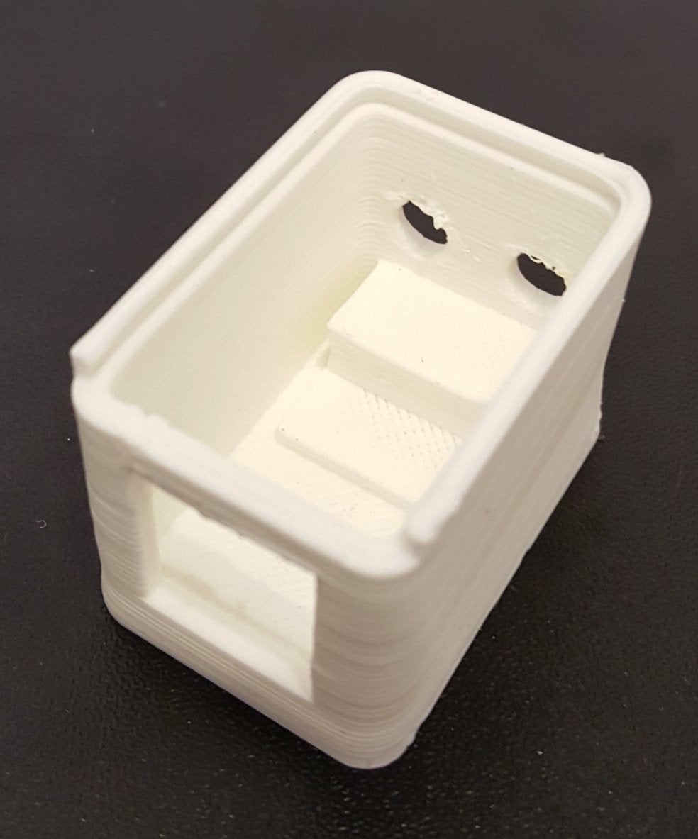

  5. Enclosure ( I use 3d design https://www.thingiverse.com/thing:2601362)

If using the 3D printed enclosure then the punch down socket just inserts into the enclosure and is twisted down to secure on a back ledge. Double sided tape can be put onto the base of the socket before inserting to make it secure.

If using the 3d printed enclosure then slide lid on to complete the box.
