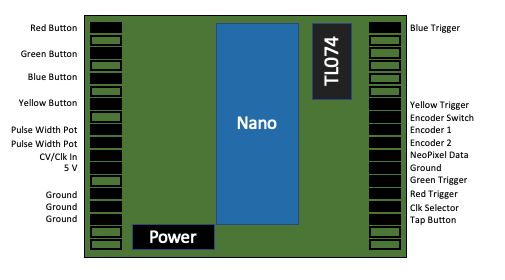

Begin by laying the components on the board to get a sense of spacing and orientation. Obviously the Nano takes up a good bit of space, and needs to be oriented so that the USB plug is accessible for programming. If you intend to power the board with a Eurorack-style power bus, then you'll need a 2x5 male pin box connector for +12V, -12V, and ground. I wanted to include a TL074 operational amplifier on the board to buffer the outputs from the Arduino. A buffer provides the module output signals with a bit more "oomph" and prevents the Nano from being loaded down. If you don't intend to hook the module to many other things, then you might be able to forgo the op-amp, but I don't recommend it.

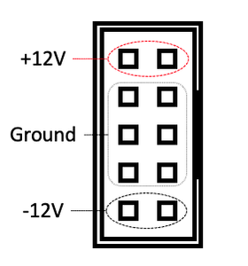

The Eurorack power connector can be soldered straight onto the protoboard. The Nano and Op-Amp should NOT be soldered directly to the board. For the Arduino, solder a pair of female header pins onto the board and plug the Nano into the headers. Similarly solder a 14 pin IC socket onto the board where the op-amp will go. This will prevent you from inadvertently damaging the Nano and op-amp during the soldering process. In the future if the Nano or op-amp are damaged, you can simply pop the old components out of their sockets and replace them.
A few comments about power connections are worth noting. Eurorack connectors use Insulation Displacement Connection (IDC) ribbon cable, and plugs have a notch so they can only go in one way. Vin on the Nano should be connected to +12 volts from the Eurorack connector, but the op-amp requires both + and - 12 volt connections. Pay close attention when making connections between the Eurorack jack and Op-Amp to avoid mixing the two voltages up. If you don't have a Eurorack power supply or don't want to use one, you can power the Op-Amp (and Nano) using a pair of 9 volt batteries. Connect one of the negative leads from one battery to the positive of the other. Voila! The unconnected positive and negative leads become + and - 9 volts, and the connected leads are now ground.
Use the provided circuit schematics as a guide for what pins to connect between the Nano, Op-Amp, resistors, and board edge connectors. For pins that are adjacent, create small solder bridges between the pins. Use solid core jumper wire to make connections between components that are further away, carefully bridging the wire and pins with solder as shown in the board photos. Use a multimeter with a continuity test feature to make sure you have connected the pins you intended, and don't accidentally create solder bridges between adjacent pins. Careful planning, patience, and consistent testing really pay off during the soldering stage; and you'll be rewarded with a module that works reliably.
