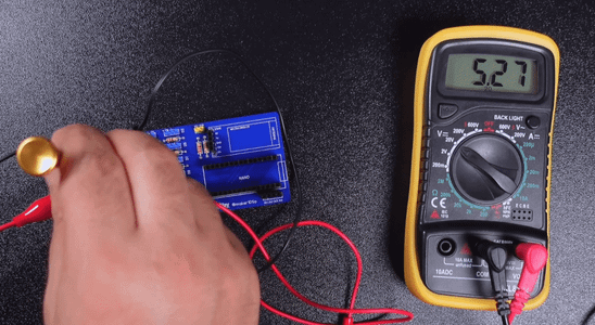

After soldering, make sure that the circuit power line provides the correct voltage. To do this, first, adjust the potentiometer on the power module using a screwdriver to the output voltage level suitable for the power requirement of the servo motors. The potentiometer must be moved slowly and carefully as it requires a very fine adjustment.
Next, check for the correct function of the jumper, which can interrupt and complete the power line to the servomotors. The circuit is powered via the connector; the microcontroller and servomotors are fed directly from this power supply. During programming or communication via USB, a servo motor power cut-off jumper is used to prevent the servo motors from drawing high currents and damaging the microcontroller or computer. When the jumper is plugged in, power is supplied to the servomotors; when the jumper is removed, the power supply to the servomotors is cut off. This allows control and safe management of the servomotors.

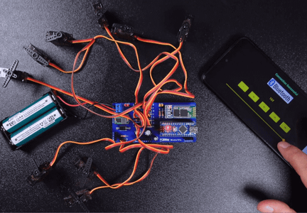

After testing the power supply of the circuit, let's move on to the multiple servo motor test. 9 micro servo motors with an average operating voltage of 5 Volts are connected to the circuit. When connecting the motors, you need to pay attention that the pins are connected in the correct direction. The PINs to which the signal legs are connected are marked on the board, so the servo motor signal legs (usually orange in color) must match these pins.
Next, open the shared source code. As much explanation as possible has been added when creating the code, so it will be easier for you to understand the code. The standard Servo motor library has been added, and an array for servo definitions has been created since multiple servos are used. PINs to which servo motors are connected are defined. Two variables are defined for start and end positions. Also, one more variable was defined for delay time.
In the "Loop" section, two "for" loops are created so that the motors will rotate from the start position to the end position and then back to the start position with the opposite rotation. After uploading the code and disconnecting the USB connection, we connect the power supply to the circuit. As you can see, the servo motors are not powered without the servo power jumper in place. An on/off switch is also preferable instead of a jumper.
As observed, the circuit works well and provides smooth movement even though the servo motors are all running at the same time. However, there is currently no load on the servos, so it will be necessary to wait and observe the next project to evaluate the actual performance.

Step 8: Control Servo Motors Via Bluetooth Using the App
Once you have the app, turn on your device's Bluetooth connection. Then, launch the app, click on the Bluetooth icon, and connect to the HC-06 Bluetooth module among the listed devices. If a password is requested during the connection, complete the connection by entering the password '1234'. When communication is established, you will see 'Connection Successful'. You can now wirelessly control a servomotor or multiple servomotors via the application. As observed, the Bluetooth connection, the communication between the board and the app, and the servomotor movements are working perfectly.
