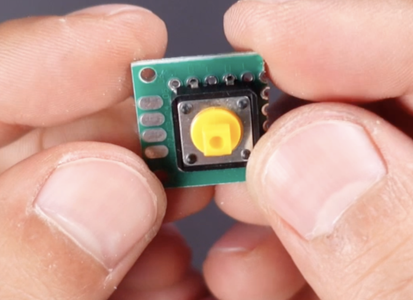

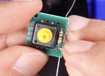

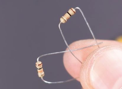

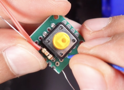

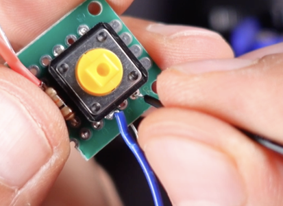

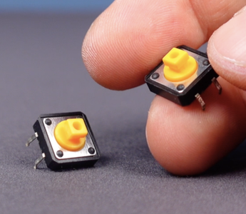

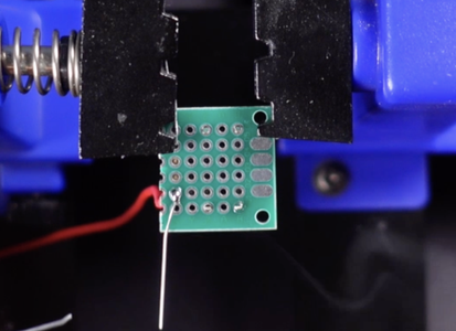

Step 1: Tactile Switch Button Circuit
First of all, two tactile switch buttons are needed to read the thumb actions. I also used drilled PCB to build and fix the switch buttons circuit. Finally, a resistor is needed for the switch circuit to work properly. With the help of a soldering iron, I solder and fix the circuit components and complete the connections. After the two switch circuits are prepared, I fix the switches with the help of glue on the inside of the back cover of the 3D box where the whole circuit will be placed. Then, I commonly connect the switch circuit power line with the help of a clip.
