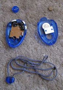

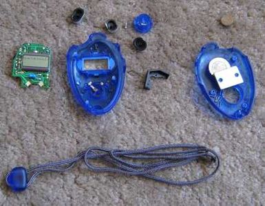

Step 1: Dissemble Watch
Take the watch apart.

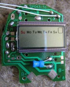

Step 2: Route Switch Wires
Add wires to the start/stop switch. Check the polarity of these wires and mark them with a sharpie to keep track.

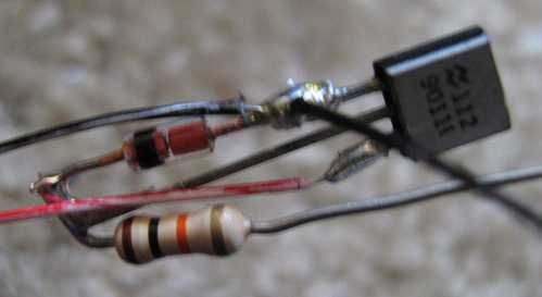

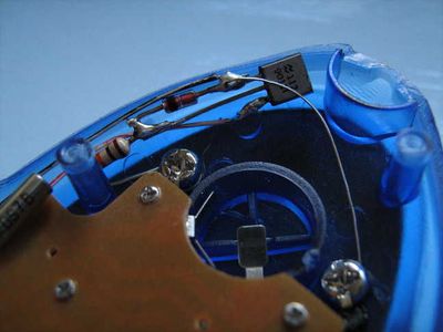

Solder the following circuit. Here's how it works:
When there are 0V across RED-BLK, the transistor is non-conducting.
When there are > 0.6V across RED-BLK, the transistor conducts.
When there are < 0.6V across RED-BLK, the diode protects the transistor from reverse breakdown.
The 10K resistor limits current into the base.
Transistor turn-off speed isn't critical in this case, but if it was, I'd recommend adding a 1K resistor in front of the 10K resistor and a 10-100nF capacitor in parallel with the 10K resistor. This would help to quickly add to, and remove base charge to the transistor.

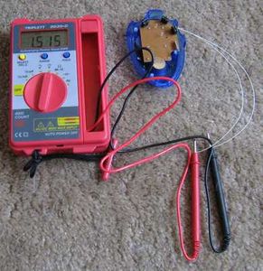

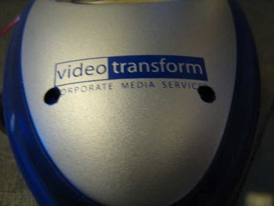

Step 4: Add Prongs & Finish
In this step, add some screw prongs by drilling holes slightly smaller than the machine screws you will be using. After, reassemble the watch.
