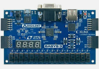

  • Basys 3 Board

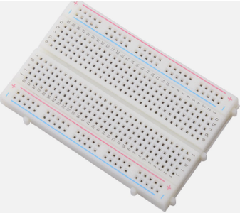

  • 1 Small Breadboard

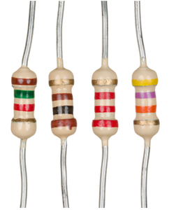

  • 4 Resistors (Under 1k Ohms is OK)

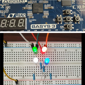

Step 4: Wiring/breadboarding
I have included this visual diagram of how the LEDs should be wired. It is a basic way to do so. Each color wire on the left represents a different output of the Basys 3 board. Using the Basys 3 board, I personally used the PMOD output ports to give signals of 3.3V to each of the LEDs. Whichever way you give the output signals, you need to plug each of these colored wires into what port you assigned the outputs. Make sure that your ground wire is connected. There is a GND port near the PMOD ports.
