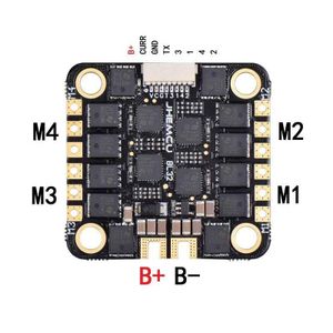

Step 3: Electronic Speed Controller (ESC)
This is the JHEMCU 40 amp 4-in-1 ESC (Electronic Speed Controller) and it comes with 14AWG wires, an 8-wire cable, and 1000uF 25V capacitor. It doesn't come with an XT60 connector so you're gonna have to buy that separately. It also doesn't come with M4 gummies (so that it fits snugly with your M3 screws). All of my previous builds and all my previous flight controllers and 4-in-1 ESCs used to come with these gummies so thankfully I have a couple lying around. If this is going to be your first build or if you don't have any extra gummies lying around, you might want to order some, or getting a different ESC. But for about $30 you really can't beat the price of this thing.
So you just need to squeeze in the gummies through the M4 holes. For the capacitor it came with, it's adequate only if you're going to be using a 4S battery (16.8v max), but since we're planning on using this with 6S battery, you might want to consider getting something like a 1000uF 35V capacitor because a 6S goes up to 25.2v.
Next we just need to pre-tin all of our pads. Pre-tinning is basically just applying solder onto the bare copper pads so that it's easier to solder wires and capacitor (which would also be pre-tinned) onto them. For the capacitor, we shortened the legs as short as we can, and we solder them on the underside of our ESC. Once we have that out of the way, we can solder the thick 14AWG wires on the top side.
Once you're happy, you can just plop it onto our frame and make sure it's flat. You may have to bend the capacitor so that it lays flat. We also need to solder an XT60 connector to the other end of our 14AWG wire. Pictured is an Amass XT60 connector which I recommend because it comes with a shroud, so you don't need any more heat shrink, though I still recommend you get a set of heat shrink for general use. Those of you who are going to be building for the first time, get yourself one of these connectors and they usually come as a pair, so you just get a whole bag of them. This is the male connector. It's male because you judge the "gender" of the connector with its copper pins. I also recommend that you get the female side of the pair and plug into the male side when soldering because the heat might deform the plastic otherwise. Remember to slide in the shroud through the wires first before you solder the actual connector, and that the flat side of the XT60 is the positive side.
If you have some helping hands or Blue Tack, because the XT60 gets a little bit hot. Let's pre-tin this XT60 connector with a little bit of solder, then grab your tweezers then melt the pre-tinned solder together. Once you're done with both wires, just slide the shroud and snap it close.
Spec Notes: I used a 4-in-1 ESC, meaning it has 4 ESCs (one for each motor) on a single board. This makes life much more convenient than buying 4 single ESCs, but it's your choice. I also used a 40A ESC here. You could get away with a 30A ESC, but it's safer to go higher to make sure your ESC has enough amps to drive the motors even when flying aggressively.

Each motor has 3 wires, and there are 12 pads in total on our ESC for our 4 motors. It doesn't matter at this point what order the wires are soldered on the ESC, as long as they are grouped together by motor. It's a good idea to trim our wires first, so that there isn't too much extra slack. Not only is it neater, it also prevents the wires from accidentally getting into the propellers and getting chopped off. Once trimmed, pre-tin the wires and solder them onto the ESCs.

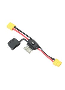

At this point you might want to take out your smoke stopper and you plug in one end to your battery and the other to your quad. What a smoke stopper does is it limits the current, so if you do have a short it doesn't burn all (or hopefully none) of your components.
If you don't have a smoke stopper but have a fairly modern smart charger like an ISDT Q8, ToolkitRC M6D, or something similar, you should have an option to output power to one of its output channels, you can just set it with a low maximum current like 1.0A. It just needs enough juice to turn on the flight controller and ESC, but if anything goes wrong it's not gonna supply a lot of current and won't burn your parts.
So before we solder any of our components to our flight controller, plug it in to your smoke stopper or smart charger, and it should power right up without a problem and without any smoke.
You would want to do this periodically after each step.
