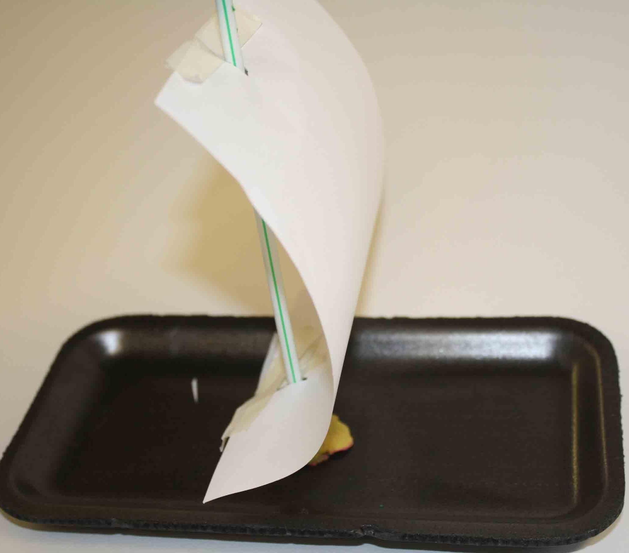

  • Foam meat tray or egg carton top
  • Small DC Motor
  • Craft Sticks
  • Small gauge wire
  • Paper Clips
  • Hot Glue Gun
  • Battery (Battery Holder Optional)
When it comes to your students' building projects, it's important to consider their abilities and your comfort level before choosing the appropriate level of complexity. Kelvin Science offers quality parts and materials at affordable prices, making it a great option to explore. Foam trays from your local grocery or meat market can also be a good alternative. To test the fan boats, stream tables, gutters, and small kiddy pools have all been effective in the past. In fact, we even used a mud puddle outside the classroom for testing one year. While tape and standard glue can be used to assemble the fan boats, hot glue guns are the most effective, affordable, and time-saving option. If you need materials for small projects, DonorsChoose is a great resource to quickly acquire a class set of glue guns and glue sticks. It's also an excellent tool to share with parents for fundraising efforts.
Hot glue is a convenient option when building fan boats, but students must handle it cautiously to prevent burns. Low temp guns should be used to minimize the risk of injury. Students should also remember specific requirements, such as the motor mounting and the propeller's radius height above the water. To strengthen the foam hull and provide a surface for gluing the motor and propeller supports, attach two craft sticks inside the foam hull parallel to its length. This prevents the foam from tearing apart while removing the glue. While the investigation is designed for three propellers, students can only compete with one. For many years I had students use old file folders to cut the propellers out, put a small hole in the center, and use a small amount of hot glue to attach to the motor. This makes it easy to remove and test a different propeller. These are the "I Can Statements" I used with this project. I have also attached all the data collection worksheets that I have used. Most time I have students use a science journal, and we discuss the best way to record our data and let them develop their own charts, but it is helpful to have something to give students if they are struggling or you run out of time.

My fifth graders created the Fan Boat Student Directions to share with other students. As a teacher, I try not to influence the design too much, but some students will find this easy, and others will need all the help they can get. I added the direction for those students in the middle so they still have some independence but need some direction and support. Some things to avoid in the design.
The more weight, the more water that gets displaced. The result is more force needed to move the fan boat.
Students always position the motor and the propeller too close to the water, and when they try to increase the size of the propeller, it ends up in the water.
Battery size: I always limited students to a single AA battery. This was just due to a lack of funds. Batteries are not cheap, and a good AA lasts a long time.
