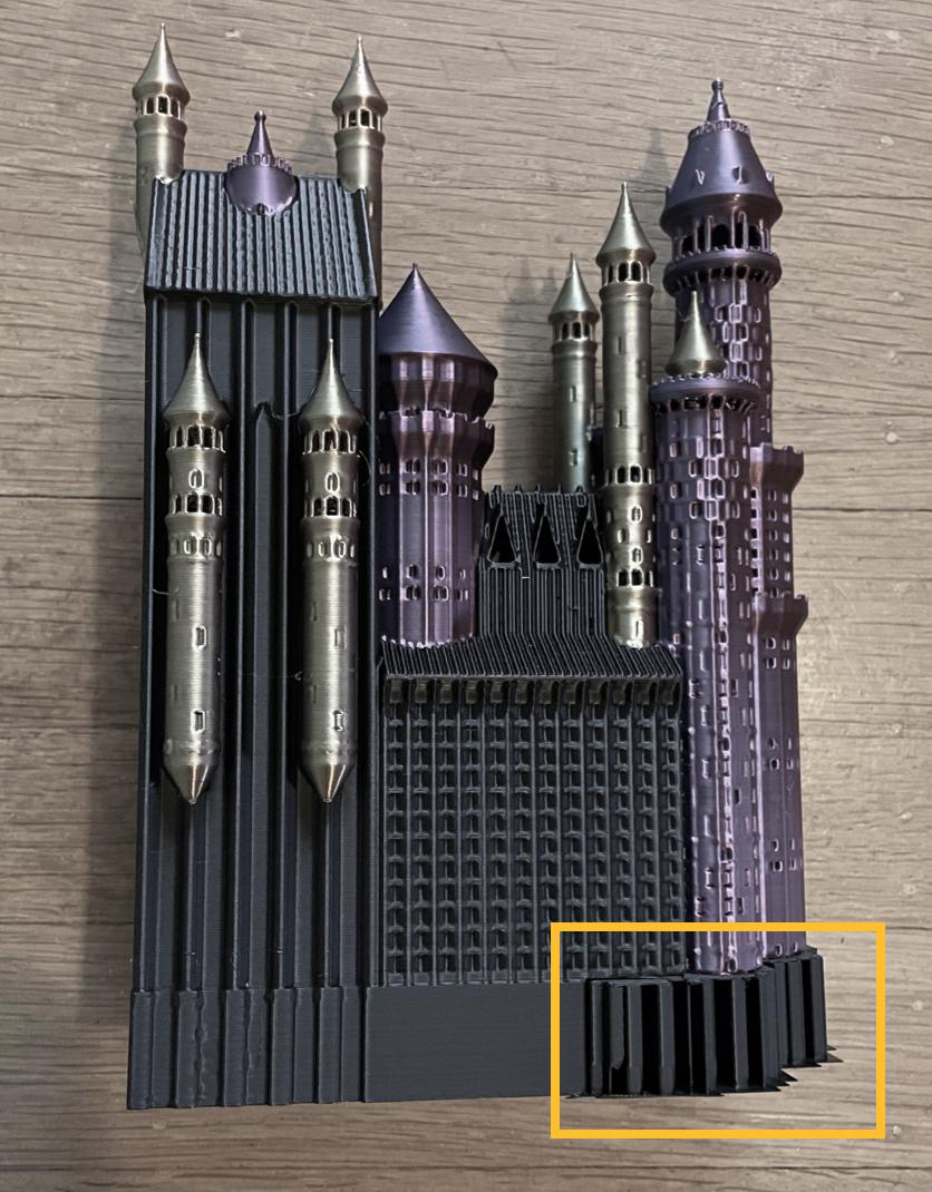

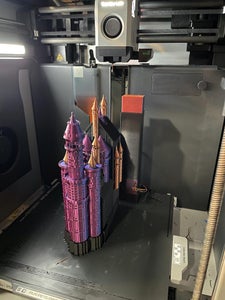

For FFF/FDM: SUPPORT IS NOT NEEDED - except immediately under the large front towers on the Castle part (as shown in the image highlighted in a yellow box)
Note:

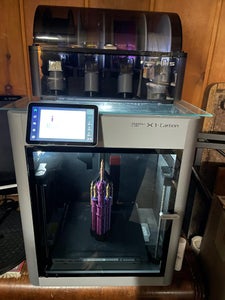

On the Bambu X1, each multicolor print took over 40 hours at a 0.24mm layer height and three colors. Single color should take less than 20 hours each.
For Non-Bambu(or equivalent FFF printers with 32 mm3/sec extrusion and 500 mm/s movement speeds) these prints will likely take 2-4x longer.

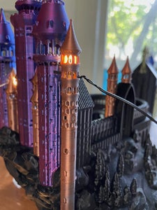

Use the following steps to light up any or all of the different towers for light. The image shows which towers can take the light string and shine light out. The left and right images are of opposite sides of the full piece.
There are twelve towers that can be wired up. In addition, the middle portion of the castle has windows open to the inside, so bunched up light left in the large inner cavity shines through there and underneath in the base.

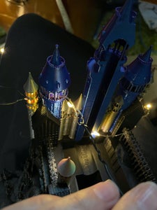

  4. Hold the light string in place with a bit of the thin gauge wire stuck under the light and ideally between the two light wire strands. (See image) This is a temporary measure so that when we perform the next step, we don't accidentally pull out the wire in this tower.
TIP: I find having the light string on when wiring them in place helpful as I can see where the lights are.

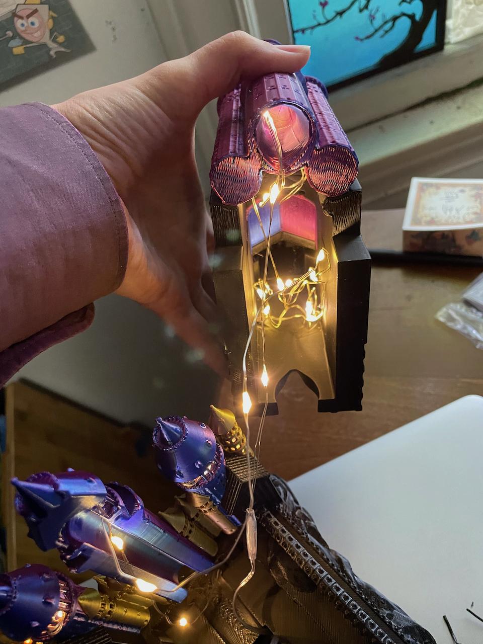

The last step of wiring the base is placing some lighting in the open area of the middle fat tower.
  1. Loop the light string and hook it around some columns like in the previous steps.
The remaining ~3 inches that go from the top of the tower down to the base/opening will provide the necessary length to allow the castle portion to be taken off and on while still attached by the light string. Like that shown in the picture.

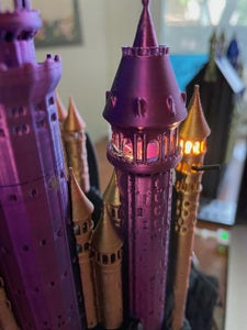

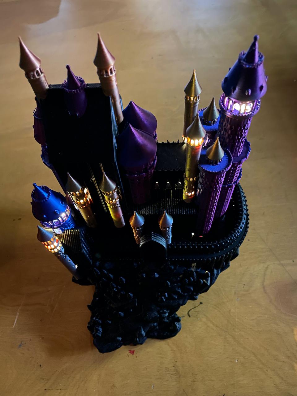

You should now be done with wiring the castle. The image shows sort of what the wiring should look like here.
Step 10: Finish
  1. Place the battery into the rectangular cavity within the heart of the base part.
  2. Carefully stuff all the remaining loose wire up into the cavity of the castle and the bit of wire from the base middle tower into its verticle cavity.
  3. Place the castle into the base piece.
  4. Turn on and enjoy
