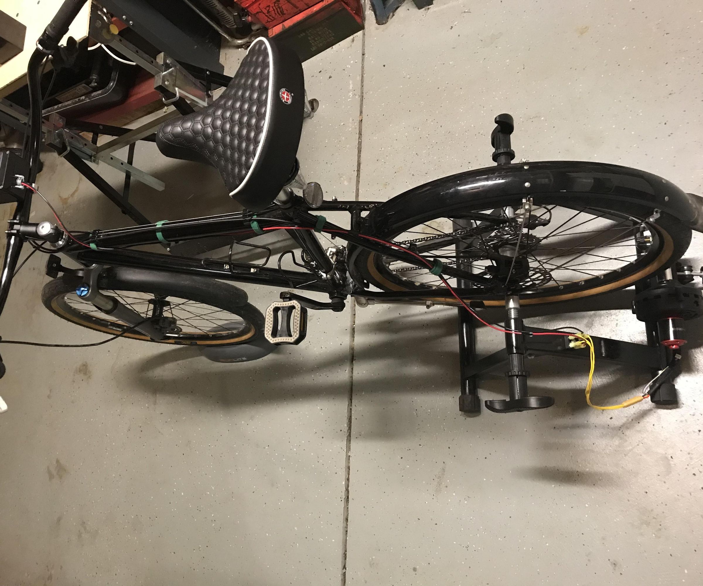

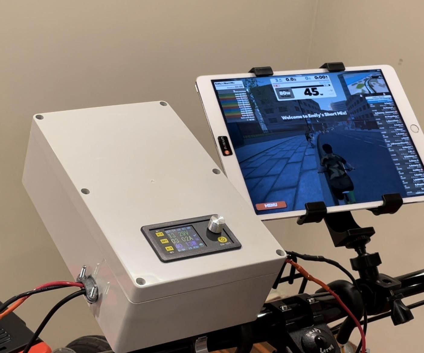

I've been on the lookout for one of these type of devices for a while. The lower priced ones have about the right capacity for my needs, but they don't accept much input wattage. I want to be able to use my pedal generator (see my generator plans: bike trainer, spin bike, exercise bike) to charge up the power station during my workout in the basement, then bring it up stairs and plug in my phone, laptop, iPad or whatever and charge those devices up with the watts I've generated. On my pedal generator, I'm usually producing 100-200 watts depending on how energetic I'm feeling. Most of these smaller (200-400Wh) solar generators only take 40-60 watts input.
