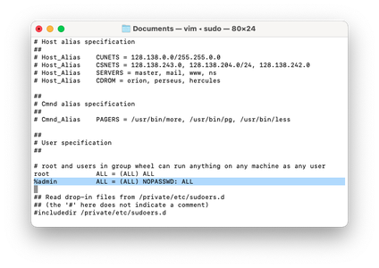

Step 4: Disable Password Authentication for Sudo Commands
The sudo command requires a password by default because some sudo commands can do damage to your operating system. It's possible to delete important files and disable security features - we're not doing any of that but you should understand the risks, don't play around with sudo commands basically. All we're doing is restarting core audio, but unless you want to enter a password every time you need to allow your user account to enter sudo commands without a password.
Open terminal and type "sudo visudo". An editor will show up with a bunch of lines of code. Scroll down until you see the line "%admin ALL=(ALL) ALL". Edit this line to read "%admin ALL=(ALL) NOPASSWD: ALL". You'll need to navigate with the arrow keys, make sure you copy this exactly. When you're finished press escape, then type ":wq", the editor will exit.
