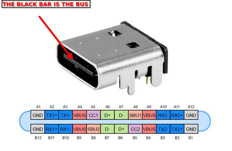

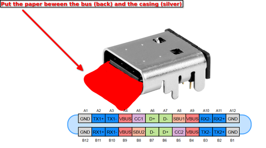

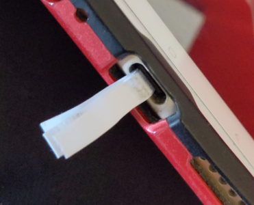

Insert this paper between the phone casing and the USB-C bus (the "thing in the middle" of your usb port)
Now when you plug the phone the male USB-C will press against the paper, making it fit tighter to the connector.
Note: in the picture I meant black and not "back"

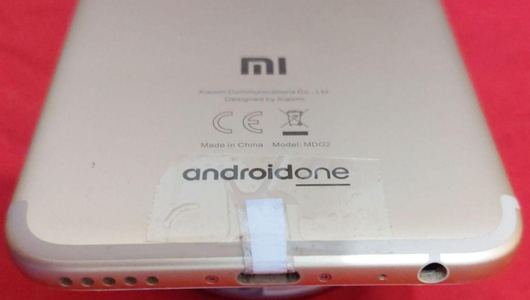

Tape it to the back of the smartphone, now it won't budge and you won't loose it.
Step 4:
Voila!
