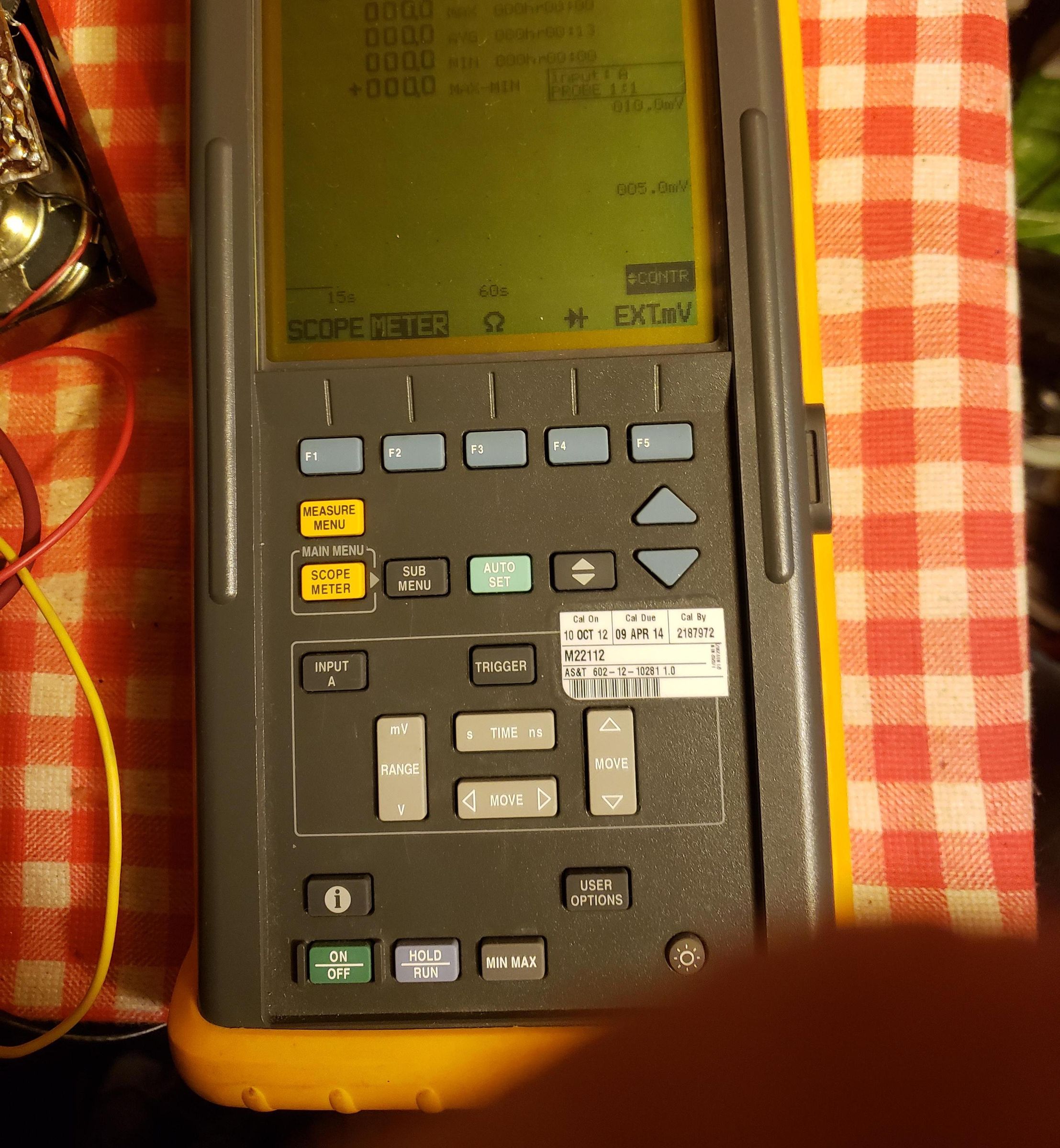

Step 5: Checking Resistance Element in Cord
The four tubes have voltages that consist of 2-25 volt heaters and 2-6.3 volt heaters adding up to 72.6 volts at .3 amps. In order for them to be across the total line voltage, the resistance cord would need to drop 40 volts across it adding up to 112.6 volts. In addition there is a 30 ohm power resistor in series attached to the chassis. This resistor would drop an additonal 9 volts adding up to a total of adding up to 121.6 volts. The resistance of the cord should be 40/.3 = 133.3 ohms. I checked the cord resistance wire and it was approximately 130 ohms. With some more checks with the ohmmeter for shorts, I was now confident to plug the radio in. The tubes at first didn't light up and this told me that the plug end of the heater was connected to the wrong side of the plug. It and the tubes were in series and they needed to be wired from hot to neutral. The plug that plugged into the back of the set was wired so that that AC would flow no matter which way the two prong plug was turned but the filaments would light with the end of the resistance cord tied to only one of the prongs and not the other.
