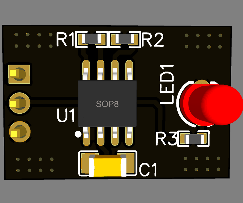

In total, there are 10 pin headers on this module.
The 6-pin header, which is found on the left side of the PCB, is the most important header.
The two separate 2-pin headers found on the left-side is just for more induvidual customizability and to make the PCB more rigid.
You can choose yourself if you want to connect these pins to either GND ( - ), VCC ( + ), or just leave the pins not connected to anything at all (NC).
These pins are there for an alternative power connection so that you don't need to connect the power to the main header (6-pin header). (Altough, the traces connected to the 2-pin headers are quite small and will not be as good and it may not be as good as using the main header.
Please note that if any of the 2-pin headers are going to be used, please solder the jumper pads so it matches the function you want.
The middle pad is either soldered to the right ( VCC ), to the left ( GND ), or no connections at all ( NC ).
Now, let me explain each pin of the main header.
(Arranged from the top, aka the square pad, to the bottom.)
Pin 1.
(square pin) This pin is the VCC Input Pin. Please check the voltage rating for the 555 Timer IC and the diode and such, to avoid supplying the module with a voltage higher than it can handle, resulting in damaging the module forever. The most normal supply-voltage of this module is 5v-12v DC.
Pin 2.
This pin is the GND pin, or the negative (-). This GND pin and the VCC pin is nessecary for the circuit to work. Connect this pin to the GND (-) pin of any power-supply or battery.
Pin 3.
This pin is the Enable pin. Simply connect this pin to any power source (1-12v normally), and the output will be enabled. Supplying 0v (when the power to this pin is turned off) to this pin will result in the IC not getting any power, therefore turning the output off. This will result in minimal power usage in its now 'off' state.
Pin 4.
This pin is the Capacitor-1 pin. This pin should be connected to a singular leg of an external capacitor of any value.
The value on the capacitor is what chooses amount of time the output will stay on for and stay off for.
The second leg of the capacitor should be connected to Pin 5.
Pin 5.
This pin is the Capacitor-2 pin. This pin should be connected to the other leg of the same, previous mentioned capacitor.
Pin 6.
This pin is the Output pin. This is where the output signal goes. Here you can connect whatever you may need to flash on and off. It can be a LED, A relay, an octocoupler, a buzzer, a transistor, basically anything you can imagine !
The output voltage should in theory be the same as the input voltage.
Step 2: How to Activate/Disable the Inbuilt LEDs
In this module I added some inbuilt leds to tell us everything we need.
These LEDs indicate when power is connected, when the module is enabled, and it shows the output.
To activate these LEDs you need to just solder each induvidual jumper pad, which lies under the IC, together.
NOTE! Do not solder all of the pads toghether, only solder each pair induvidually!
The first jumper, aka 'U4', is the one controlling if the OUTPUT led is activated or not.
The second jumper, aka 'U3', is the one controlling if the ENABLE led is activated or not.
The third jumper, aka 'U2', is the one controlling if the POWER led is activated or not.
To disable the leds you need to un-solder the solder pad. (That is if you allready have soldered them, if not; you dont need to worry!)
