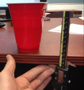

A flip cup trophy would never be complete without a plastic cup in the design. So I grabbed some quick measurements using a pair of calipers to model the ubiquitous red plastic cup. A fun trick I have shown is to zero out the calipers on the desk, and by holding the lower arm of the calipers I have a make shift height gauge.

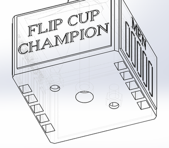

One problem I have with my design is it has negative draft and is impossible to print with my printer. So I will make the trophy in 2 pieces.

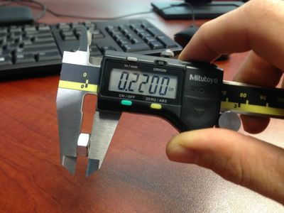

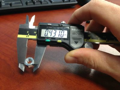

I have measured a regular 1/4-20 hex nut and designed a cavity for it to fit into the top half of my trophy. I generally use about .015" per side for a light press fit.

Step 4: Scoreboard
I have decided to add a scoreboard to each side of the trophy for tallying how many nights the battles of the sexes has been won.
In an attempt to keep the trophy clean of free handed human marker errors, I have gone with a punch card design.
Each side has 5 columns that are only connected in the corners and can be punched out after a team emerges victorious.
