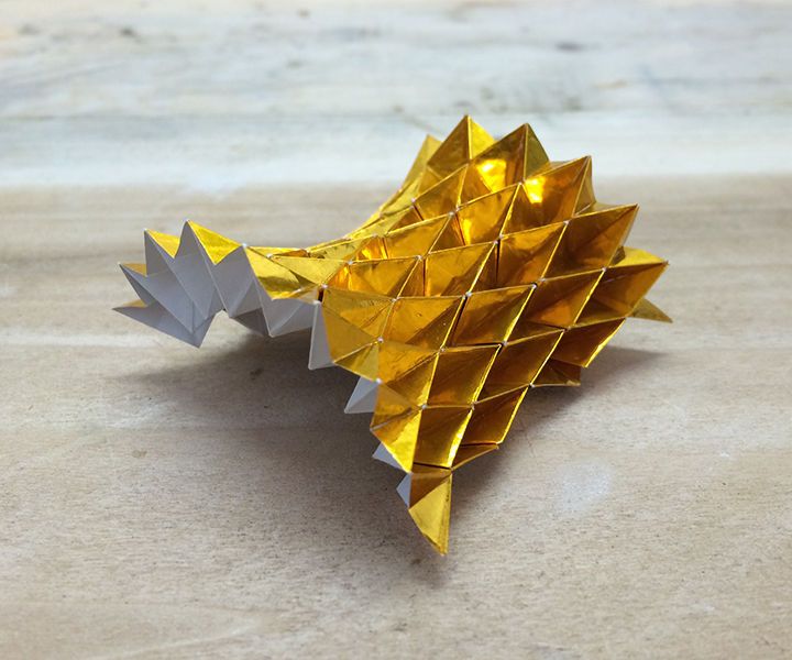

Anyone who starts playing around with origami pleats and tessellations will probably discover this fold themselves, sooner or later. I did, and later learned that it is commonly referred to as Fujimoto's Lotus after being described in the 1960s by origami artist Shuzo Fujimoto.
The basic idea is to take a square sheet of paper and collapse its corners so that they frame a smaller square, and collapse its corners so that they frame a smaller square, and so on and so on. It's a pretty simple model to fold, but playing around with it will help cultivate an intuitive understanding of more complex recursive origami, such as Chris Palmer's famous Flower Tower and Eric Gjerde's amazing origami tessellations.
