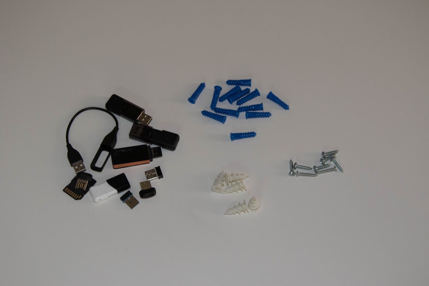

Prerequisite MATERIALS (around 25 dollars):
1. IKEA LACK table, $9.99. (1)
2. Wall anchors, 25 lbs capacity. (2)
3. Ball chain, OR thin rope, OR steel wire, than can hold 25 lbs. (your choice, 12 ft.)
4. Eye bolt, with nut, ~6mm. (4)
5. (OPTIONAL) extra nuts to fit the eye bolts (4-6)
6. washers, to fit the eye bolts, top and bottom. (8)
7. Ferrules, aluminum, to hold steel wire or ball chains. (6-8, you will break some)
