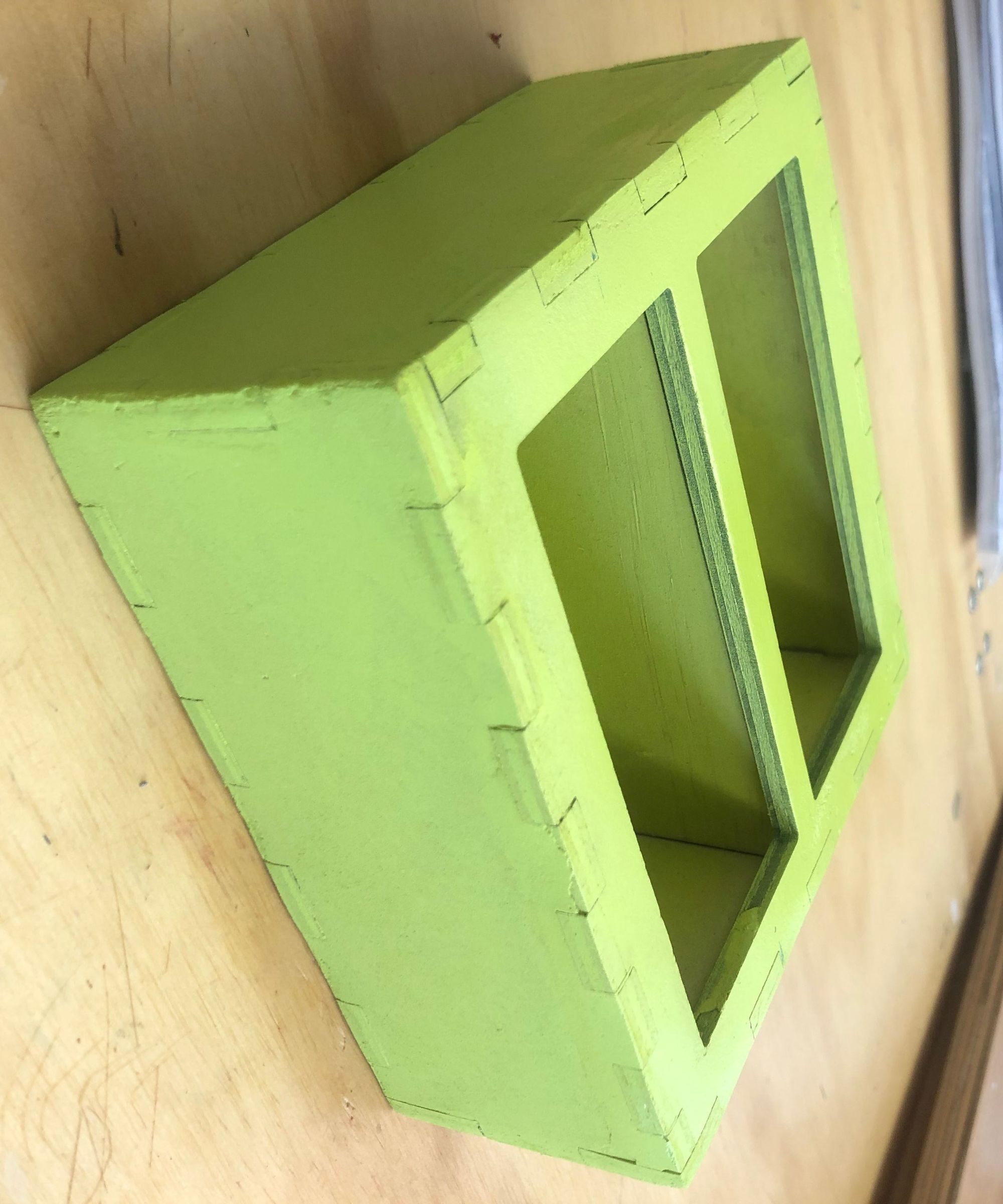

3D Model Prototype We designed our own prototype for our dispenser to scale using Tinkercad. We added the basic indentions for where we wanted our big components to be. This was most helpful in seeing how big our design would actually be, and helped us visually address how we wanted it to look in the end. You can use this model and make modifications to it with the link, or you can go to Tinkercad and create your own model. Use this for the prototype step. (add finished photo)

Once we have a planed our idea of how you want it to look, we started to build and design a prototype. We chose to make two prototypes, one out of foam to determine the size and shape we wanted our dispenser to be, and one that we 3D printed to give us a visual and add any changes. We made multiple prototypes, because of the many changes that have come up. The dimensions or the shape you can test different ones and see which one you would like the most. You can also refer back to the Pattern and File step if you want to use our 3D printed prototype. Once we had our prototypes, it was much easier to make any changes that we might not have realized we wanted to make or didn't see in your original design.

Assembly, The final step is the assembly of your product. After we printed out our final design for the shell of your dispenser (the outside). Although all we need to do is secure your Red Board and parts inside and make sure that the LED, buzzer, and LCD screen are in the correct holes so that you will be able to see them from the outside. Make sure they are secured onto the sides. After that, place your pump and motor into the center so that they go through and connect to the dispensing hole. Lastly, add the soap and close the top and bottom.

The last 2 pictures are the revised design of our soap dispenser. We only got so far but we tried our best with the amount of time that we had.
