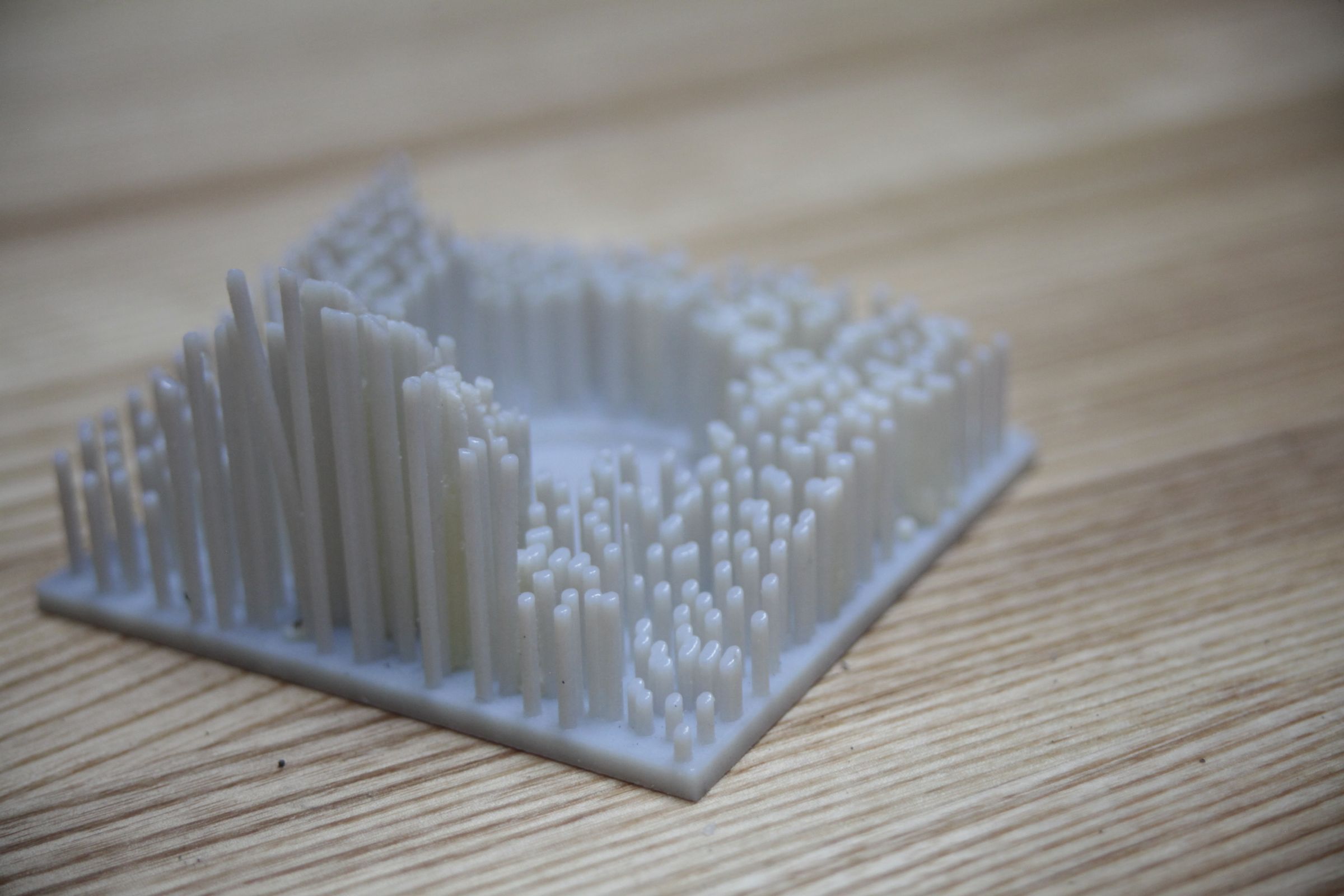

TheJehosephat: created a shadow sculpture Instructable without using software.
Ryan Meuth: his version of a 3D printed “shadow caster”. I’ll talk about this in step 7.
