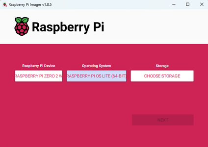

- For the "Raspberry Pi Device" field select Raspberry Pi ZERO 2 W

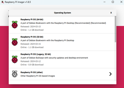

- For the "Operating System" field select "Raspberry PI OS (64 bit)" The images say to use the lite version but ignore this
- Select your storage device for the "Storage" field
- Press "Next"

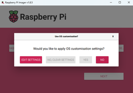

- Press "NO" for "Would you like to apply OS customisation"

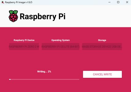

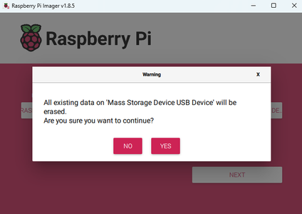

- Press "YES" to "All existing data on 'Mass Storage Device USB Device' will be erased. Are you sure you want to continue?" MAKE SURE YOU HAVE NOTHING YOU WANT TO KEEP ON YOUR MICRO SD CARD
- Wait for the image creator do be finished
