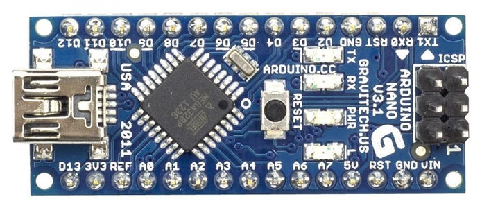

1.Arduino Nano
2.MPU6050 accelerometer module
3.Oled display 64x128
4.2xLED's (optional parts)
5.2x330...470 ohms resistors
6.buzzer

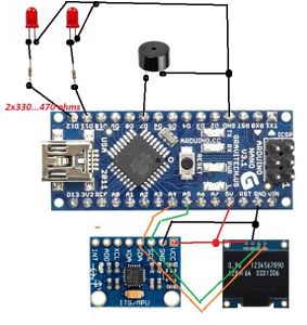

Step 1: Schematic Diagram
The electrical scheme is simple, it should not cause any problems during construction. The LEDs from pins D11 and D12 may be missing, they are optional. If you choose not to mount the LEDs, the resistors are not mounted either. The SDA and SCL accelerometer module pins are connected to Arduino pins A4 and A5. As well as the SDA and SCL pins of the OLED.

I built the assembly on a test board and made the electrical connections with a soldering iron on the back. I powered the device from a 9v battery to make the device as compact as possible. You can opt for any other type of construction, depending on your preferences. It is important that the position of the accelerometer is as rigid as possible for good operation.
