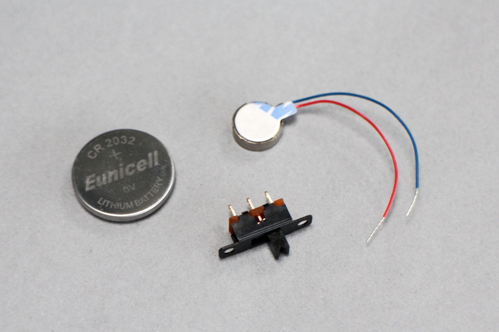

MOVE ELECTRONIC COMPONENTS
The parts you need to make ONE Move circuit assembly are:
  • (1x) 3V coin cell battery* - ($1.95)
  • (x1) vibration motor - ($4.95)
  • (x1) slide switch - ($1.50)
TOTAL COST (before tax & shipping): $8.40**

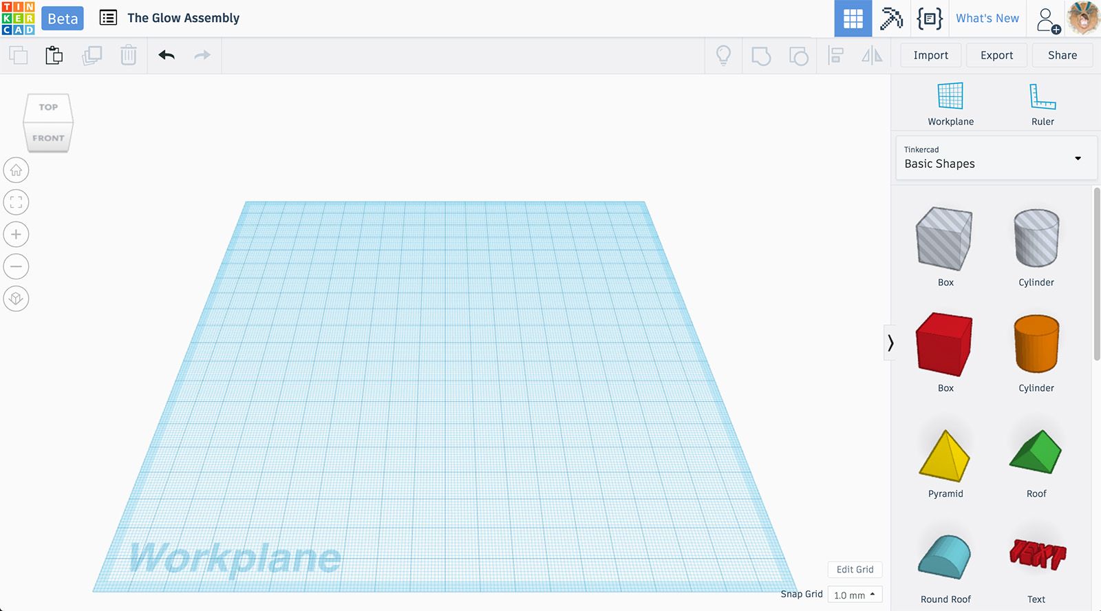

Step 2: Where the Circuit Assemblies Live in Tinkercad
I'm going to assume that you have at least a yellow belt in Tinkercad use, so I won't be covering the basic concepts of Tinkercad navigation tools or program functions in this class.
If you have trouble following along, have a quick read through Lesson 2 of my co-worker JON-A-TRON's Easy 3D Printing Class. It covers everything you need to know to get started from scratch in Tinkercad!
OK! To see where the new Circuit Assemblies are located in Tinkercad, create a new design.
In the shapes drop down menu on the right, click on CIRCUIT ASSEMBLIES.
This brings up the 4 assembly pieces: 2 GLOW and 2 MOVE.
There is a circuits electronic components 'holder' and a cutout 'hole' for each assembly. The cutouts/holes are used to create the space in your designs that the printed holder will press-fit into.
Click and drag one or two of the shapes onto the workplane.
You'll notice that a sub-menu pops up with more info when one of the assembly shapes is selected. The most important thing to note at this point, is that the SCALING IS LOCKED on both the holder and the cutout (this is also true for the Move components). What this means is that you can move them up and down and all around, but you can't resize them.
This restriction is in place because specific, real life, electronic components need to fit into the holders, once printed, and the holder needs to fit into that specific sized hole.
NOTE: This will limit the size of your final design if you intend to have the one LED light up the entire object from the inside. But of course there's no rule that says you can't add more than one assembly to a piece if you're making a GIANT print!
