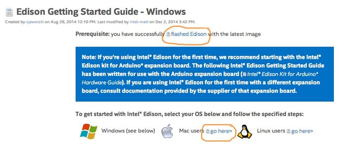

Connecting the hardware is pretty neat described here.
Don't forget to click next step in stead of Where to go next... (It's written so small that I didn't notice that...)

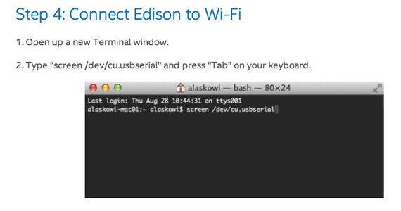

Step 4: Flashing Edison
Be aware of the space between "screen" and "/dev/cu.usbserial". Screen means show here. Watch out! Don't press enter but TAB here!
I guess typing 115200 -L has something to do with the speed we will communicate with each other?! Feel so dumb here... I'll just continue, and yes, luckily all goes well!
Ok, it took a while, I had to retry it a couple of times, plugin cables in and out, alternating ports, but I finally managed to have a screen that somewhat looked like the one shown on the flash your Edison page.

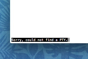

Ok, sometimes I don't know what happens, but I loose connection I guess and the terminal excuses for not finding a PTY, whatever that may be.
My solution? Quitting the terminal, disconnecting Edison and connect/start everything again.

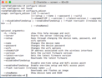

Now that I'm making this Instructable, I'm on another Wifi netword, so I don't want to fully configure my Edison again. The name and password I've chosen before are ok, but I do want to change the Wifi network it's connected to. So instead of typing "configure_edison --setup" I only type "configure_edison". This shows me a list with options :)

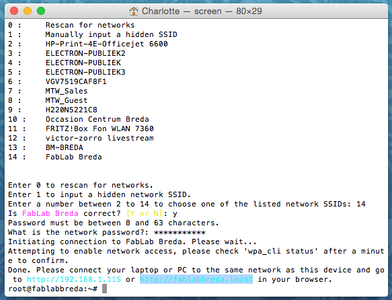

I want to chose another network so I type "--wifi". No luck. I type "configure_edison --wifi" and it starts scanning for networks :)
Type the number of your network, confirm with "y", enter the password and it starts connecting!
Unless the Terminal happily says we're done, I'm not able to see my Edison in my browser...
I scan again by typing "configure_edison --wifi" (or hey, just press the up-arrow, this will show you your last commands!)
After a lot of patience and a number of attempts I managed to get the happy screen showing my Edison :) (No luck while I'm writing this Instructable...)
