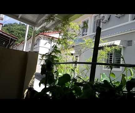

I always wanted a greenhouse for my backyard. Although I don't have a big space, I want a greenhouse for my plants and my pet called jj. FYI, I'm not from a country with 4 seasons, but only sunny and raining days. There are conditions I can't cut or hack the fence or the iron bars. Basically, I can't touch anything that comes with the house. And a ready-made greenhouse simply can't fix my need.
One afternoon, when I was busy thinking with a dolly track or 360-degree track that can easily move the plant to face the sun, it was really like a bulb suddenly light up - why not PVC pipe? Why not PVC pipes which can connect through the fence and the iron bar like a Lego? I no need it to be so sturdy because my backyard is at the back alley, where there is seldom strong wind here. So, why not? I know I might able to find lots of PVC pipe greenhouse from the internet, but I insist to build it myself. If I face the failure or error, I will learn from it, gain from it. If I follow other people design and install them step-by-step, I know I will get it fast, but that just follows, I learn nothing from it.
I drafted my drawing, of course, change during my proof of concept testing, and then at the final stage too. Then I source from the hardware shop, for the PVC pipes, the tee and elbow joints. I don't really need to measure the diameter of the PVC pipe, all I need to do is to select the pipe that looks OK and sturdy (I found there are three types of the thickness, I got the thicker one), then match with the elbow and the tee. At first, I was still doubtful, so I bought only a few of the pipes and the joints. Back home, measure how big I want and cut them into pieces with the saw for 30cm, 40cm, 80cm, >100cm, then I start my proof of concept. I have my base setup, record down the quantity of the pillars, the length of the pillars, the number of elbow and tee joints. Then disassemble it, cut more pieces and install for the first layer with the holder of the plants for only one side, then the second layer, and finally the roof. The result turns out that it is possible. So, I sum up all the measurements and going for a big time. That's really a fun process seeing things happening.
