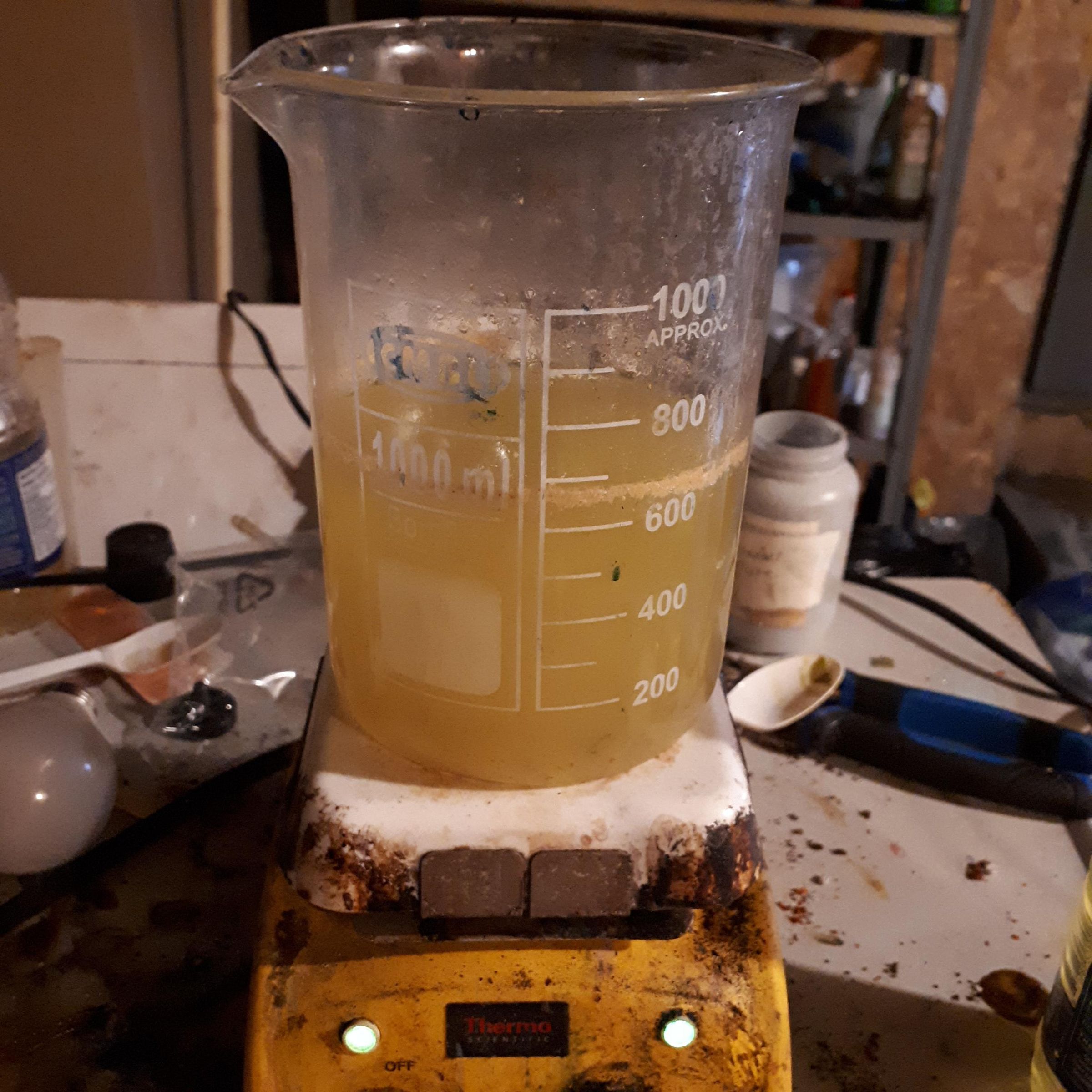

Step 2: Preparation and Mixing

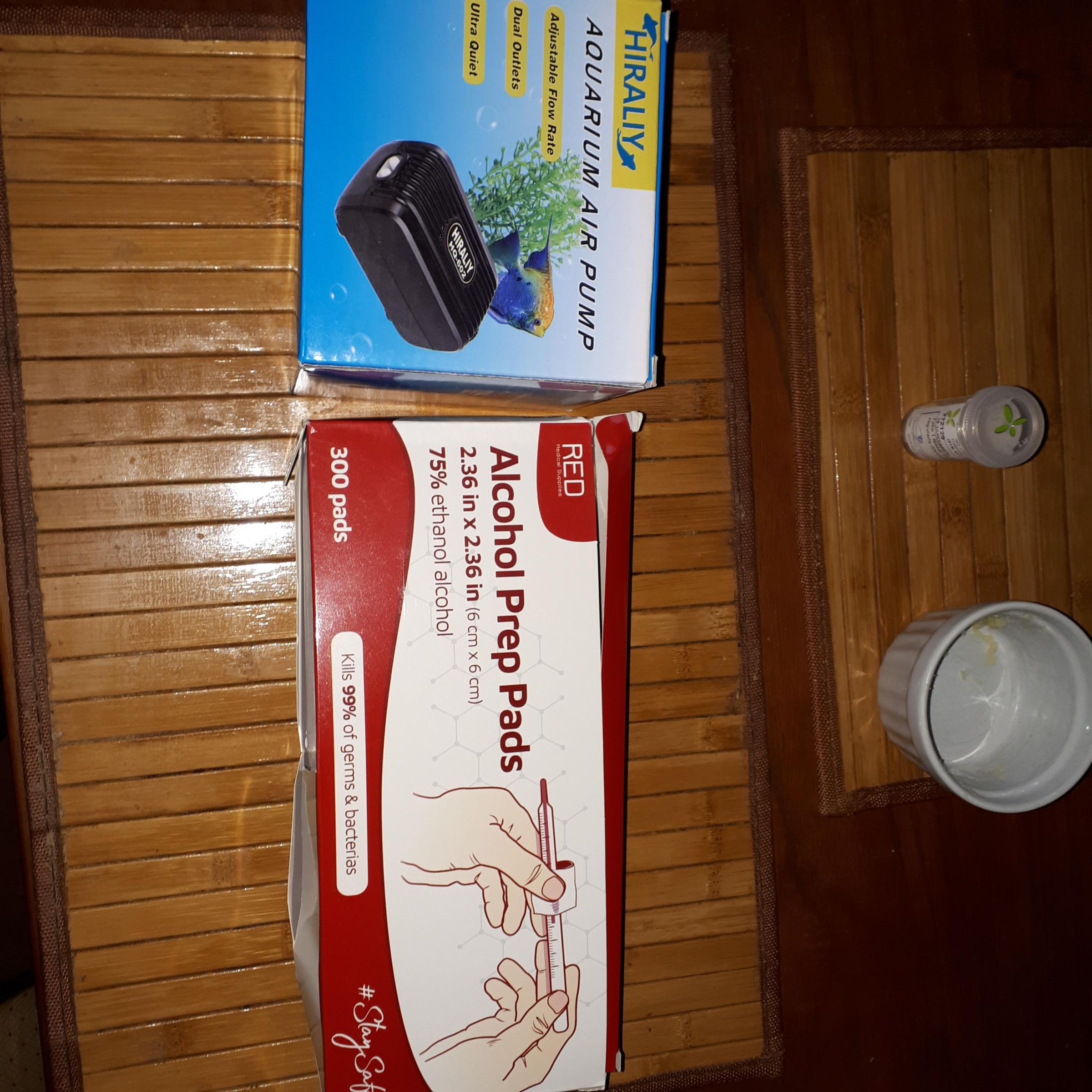

Sanitation is necessary so your batch doesn't crash. After you REALLY wash out the grow container, make sure there is absolutely no residue left. Some people say swirl some diluted bleach around. Others say to stick it in the microwave after it's completely dry (won't melt or deform if it's dry... wet is another story). Choose your preference.
Additionally, sanitize the tubing if you're using an air pump, and anything else you're using to prepare this batch.

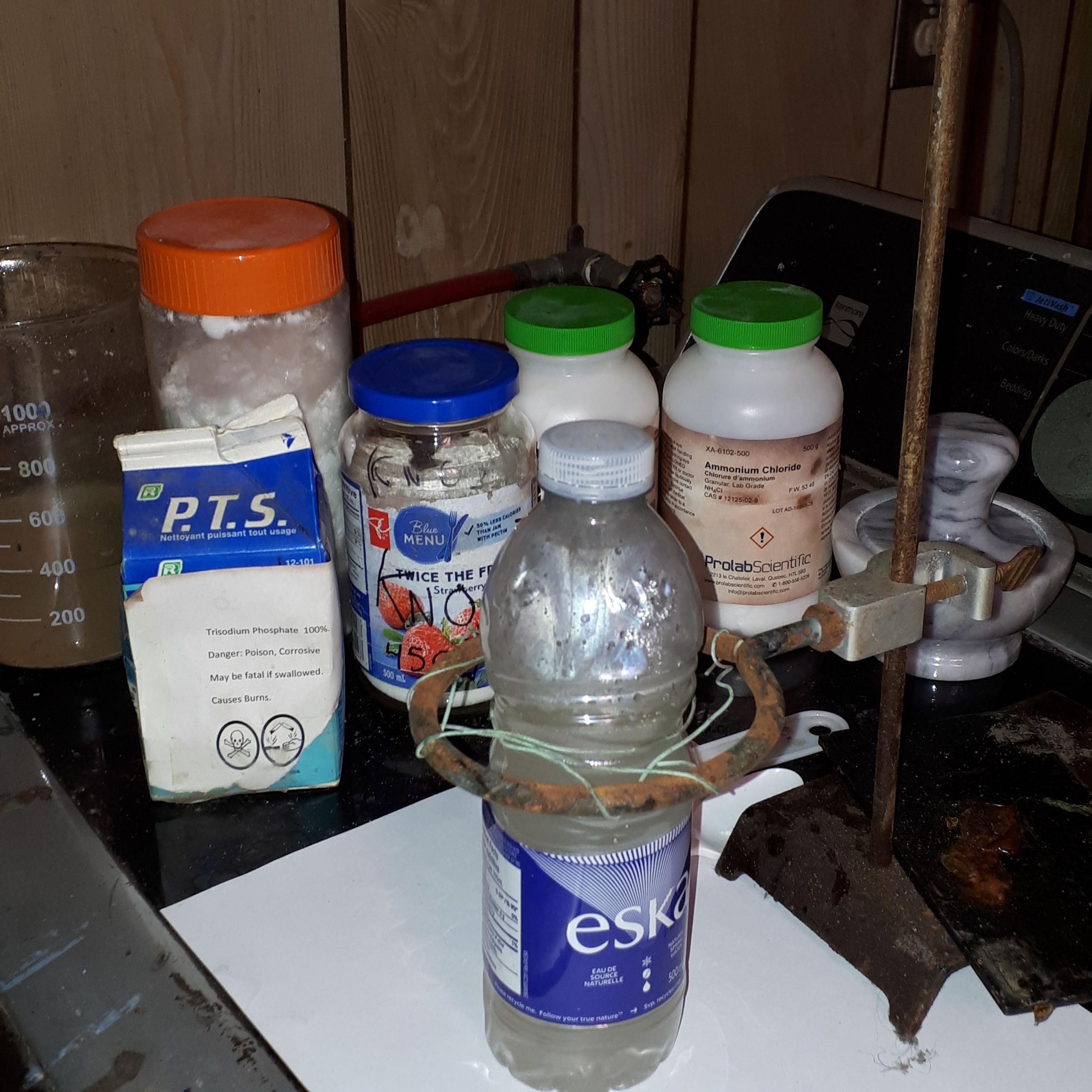

Mix up a batch of salt water. Use purified water as tap water can contain chlorine or other things that might kill your batch.
Mix the salt to a 1.019 specific gravity (sg) concentration. Directions on how to do this are on the back of the package... you'll need a hydrometer if you've never done it before.
Add in ~ 1 ml of the micro algae grow. In this case, less is more. The solution you received the culture in should already have enough nutrients to support sizable growth. If you don't want to mess with making your own solution (not necessarily a bad idea) many places that sell starter cultures will also sell culture solution.
Let both the solution and culture bag sit in the same area out of the sun for an hour or two. This is simply to let them reach room temperature. A sudden change in temp during transfer could shock the culture enough to significantly harm it. If your room temp is in the 70s (F) , you should be okay. Ideally, the water should be around 22 degrees Celsius.
Finally, transfer the algae into your bottles. Attached is a picture of a grower's setup. (Your bottles won't be green though)
