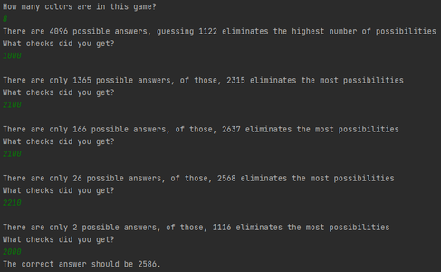

After ruling out obvious points of failure in your code, its time to start experimenting, add code to print out data at the beginning and end of every method. This will allow you to narrow your sights on exactly where the problem is. This Mastermind algorithm is built around a large matrix holding every possible solution, so I built a printer method that can easily print the array of possible answers so checking the values will be easier. I added a call to this method to every method's start and also added a few line to print each methods arguments and outputs, at the start and end of them respectively.

If it isn't immediately clear which method threw off the data, you might want to walk your test case through the steps the code it taking, and writing down what data you expect to be output at every step, to be clear when the output becomes inaccurate, and thus where to focus your attention. Be sure to address the first place where the data was wrong first, as often an early mistake being fixed can fix the later errors the code is running into. In the Mastermind program, my test case answer was 2556, but the program didn't come to this answer and gave me guess suggestions that didn't match up with my prediction. After adding print statements , it became clear which method was the problem. "convertNums" is a simple method meant to change a number stored as an integer into an array that could be operated on more easily, and the output printed at the end of it didn't match the input it was meant to convert, giving me a place to focus my attention.
Step 5: Find Exact Point of Failure
Once you have a method to focus on fixing, repeat step one, look for any complicated logic you could have made an easy mistake on, see if you can fix it through deduction. If you can't find anything repeat step two through four for the method in question, adding print statements when relevant variables have their values changed. Be careful about gathering too much data, like adding print statements in loops that will iterate hundreds of times, as this will make the output unreadable. When your search is narrowed, further and further, it will become clear which line or small section is written incorrectly. While this will not necessarily give you an immediate solution, to the problem, any mistake you have written will be traced back to this line, whether in the exact syntax, or in the variables it references. In the Mastermind example, I added print statements to convertNums and realized I had made a typographical error in one of the lines of conversion that was feeding my other methods false data. After fixing this problem I got the solution of 2556 I was expecting to receive.
