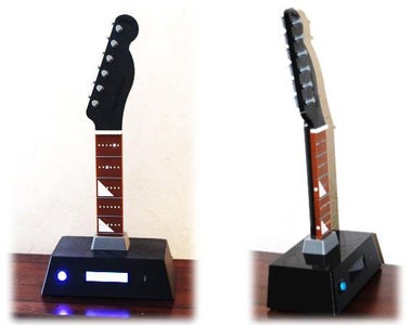

Introduction: Guitar Chord Chart
NOTE: This is a very old project, circa 2016. Some links may no longer be correct and some parts may no longer be available. However, I think that the 3D printed parts and much of the software may still be useful to anyone wanting to make a similar project.
This could be considered a remix of the Digital Chord Chart from Instructables in 2014. However, it is basically a complete redesign with original features, 3D parts and software. Its main purpose is to show the fingering needed to generate specific guitar chords. This version supports the following:
- Finds multiple variations of all standard guitar chords.
- Has a unique reverse chord lookup feature in which the user can specify string/fret fingering and the chord finder will return the name of the corresponding chord.
- Supports user selectable options for chord display.
- Has a demo mode that can be used to diagnose wiring issues (or just show off).
- Has a diagnostic mode that can be used to identify IR codes from any IR remote control.
- Is adaptable to any IR remote control.
- All plastic parts are printable on most reasonably sized 3D printers.
- All 3D parts fit together without the need of glue or other hardware.

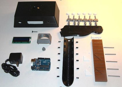

Required Tools
- Soldering Iron
- Solder
- Side Cutters
- Needle Nose Pliers
- Small Wrench or Pliers
- Knife and/or Wire Strippers
- Small Phillips Screw Driver
- Small Files or Sand Paper
- Multimeter
- Ruler
- Helping Hands with Magnifier (optional but recommended)
- Computer with Arduino V1.7.8 or Later Software Installed
- A-B USB Cable (for Arduino programming)
- Zip Tie Tool (optional)
- 3d Printer (optional)

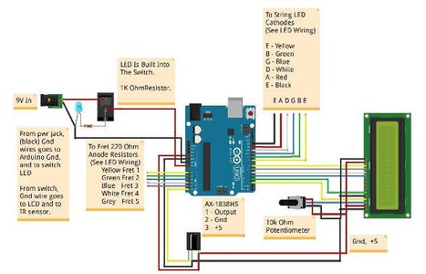

Step 2: Wiring Diagrams
The first diagram is the wiring for the base, and the second is the wiring for the LEDs in the neck. The following sections will give more detail on wiring the device.

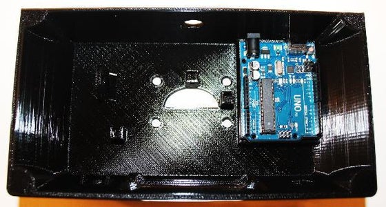

Step 3: Mount the Arduino
Insert the Arduino into the base with the USB connector protruding from the hole in the back of the base. A little force may be needed to get the Arduino to seat properly. Once the Arduino is seated, secure it with 4 nylon M3 x 6mm nylon screws.

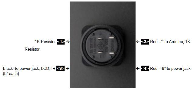

Pre-wire the Power Switch
See the diagram above. Solder black ground wires, power wires and 1K resistor to the power switch. Leave the other end of the wires free for now. Wiring details follow:
<1> – Solder one end of a 1K resistor to this pin. Keep the leads as short as possible.
<2> – Solder the other end of the 1K resistor to this pin. Also solder a 7” piece of red wire to this pin. This wire will eventually terminate at the Arduino VIN pin, but leave the other end free for now.
<3> – Solder 3 9” black (ground) wires to this pin. They will eventually terminate at the power jack, the LCD, and the IR sensor. For now, leave the other ends free.
<4> – Solder a 9” red (+9V) wire to this pin. This wire will eventually terminate at the power jack, but leave the other end free for now.

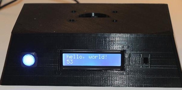

Assuming that the Blink program is still installed on the Arduino, when power is applied, and the switch turned on, the Arduino’s LED should be seen to blink.

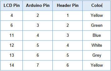

Pre-wire the LCD
All of the pre-wiring of the LCD can be done before the LCD is mounted to the base. See the diagram below for details. Note the following:
- Pin 1 of the LCD module is at the bottom of the diagram, pin 16 is towards the top.
- All wires should be soldered to the back of the board in order to leave room on the front of the board for mounting the LCD module to the base.
- Each signal wire (the wires that will end up at Arduino pins 2 through 7) should be 7” long.
- The black ground jumper wires that connect between pins 1 and 5, and between pins 5 and 16 of the LCD module should be about 2” each.
- The red +5 V jumper wire that connects between pins 2 and 15 of the LCD module should be about 3”.
Follow these steps to pre-wire the LCD module:
- Solder the signal wires to the LCD module. Use the colors shown on the diagram. Leave the other end of the signal wires free for now.
- Solder a 7” length of blue wire to pin 3 of the LCD module. Solder the other end of the blue wire to the center post of the 10K potentiometer.
- Twist the end of one of the ground wires from the power switch (see <3> of the power switch pre-wiring section above) to one of the 2” black jumper wires, and solder them to pin1 of the LCD module.
- Twist the second 2” black jumper to the free end of the other 2” black jumper, and solder them to pin 5 of the LCD module.
- Cut a piece of black wire to a length of 6”. Twist the end of this wire to the free end of the black 2” jumper from the previous step, and solder them to pin 16 of the LCD module.
- Solder the other end of the 6” black wire to either end post of the potentiometer.
- Cut two 7” lengths of red wire. Twist one end of one of these wires to one end of the 3” red jumper wire, and solder them to pin 2 of the LCD module. Twist one end of the other 7” red wire to the other end of the 3” red jumper, and solder it to pin 16 of the LCD module.
- Solder the other end of the 7” red wire from pin 16 of the LCD module (see the previous step) to the empty post of the 10K potentiometer.
- Solder the other end of the 7” red wire from pin 2 of the LCD module to the fourth pin of the Arduino power group header (or stripboard). This red wire should connect to the end of the header that currently has nothing else attached to it.
- Solder the other end of the signal wires (see step 1 above) to a 6 pin header (or stripboard) in the order shown in the diagram (see the table in the picture above, sorry but tables don't format well here ).

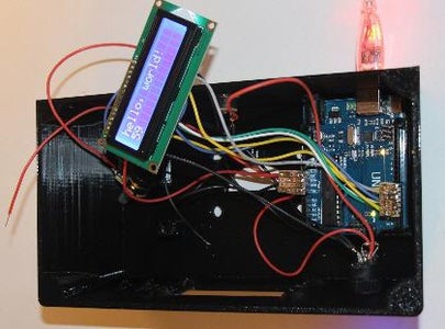

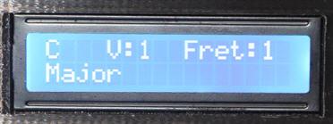

Test the LCD wiring
Attach the A-B USB cable between the computer and the Arduino. Load the IrTest program into the Arduino. Turn the potentiometer until characters can be seen on the LCD display. The LCD should now display “hello world” on first line, and the number of seconds since power-up counting up on the second line.

Now that the LCD is working it is time to mount it into the base. Carefully insert the LCD into the base.
Mount the potentiometer in its mounting bracket. Note that the potentiometer mounting bracket contains a small keying hole on top which can accept a tab that the potentiometer contains. Do not yet secure the potentiometer with its mounting nut, just in case a problem is introduced while mounting the components.
Re-apply power and verify that the LCD is still working correctly. If not, remove the LCD and verify all connections.
Secure the LCD with 3 M3 x 6mm nylon screws. Note that it will not be easy inserting the top left screw, and it will be impossible to insert the top right screw. Due to the snug fit, using 3 screws to secure the LCD should be sufficient.
Secure the potentiometer via tightening its mounting nut.
Re-apply power and verify the LCD is still working.

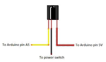

Step 7: Install the IR Sensor
Mount the IR Sensor
Insert the IR sensor into the base with its leads facing the bottom of the base. It is possible that the IR sensor hole in the base could need some filing in order to make the IR sensor fit. Once the IR sensor is in place, secure it by inserting the Input Device Holding Rod into the through the holes in the two holding rod brackets that are on either side of the IR sensor. This may require the application of some force on the back of the IR sensor to seat it properly into the base.
Once the IR sensor is mounted, use the needle nose pliers to bend the three 3 IR sensor leads toward the back of the base. The bend should be about ½” below the sensor. Using the side cutters, trim the 3 IR sensor leads to about ½” after the bend.
Wire the IR Sensor
Two options exist for wiring the IR sensor.
- Solder directly to the IR sensor’s leads.
- Solder to a 3 pin female header which will mate with the 3 IR sensor leads. I prefer this method.
Regardless of the wiring method used, the following must be done:
- Cut a 9” yellow wire and solder one end to the leftmost pin of the IR sensor (or female header). Solder the other end to the single pin male header. It will be attached to Arduino pin A5.
- Solder the remaining black wire from the power switch to the middle pin of the IR sensor (or female header).
- Cut a 9” red wire and solder one end to the rightmost pin of the IR sensor (or female header). Solder the other end to the Arduino power group 5V pin.
Check the IR Sensor Wiring
Using the multimeter, verify that there are no shorts between the pins of the IR sensor (or female header). Also verify that there is continuity between the IR sensor pins and Arduino pin A5, GND, and Arduino pin 5V respectively. Once verified, connect the female header (if used) to the IR sensor, observing correct orientation. Also connect the 1 pin male header to Arduino pin A5.

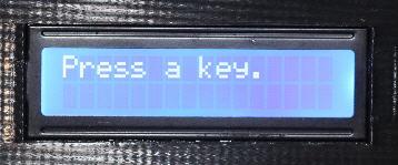

Test the IR Sensor
Be sure the Arduino IRLib library has been installed as described earlier.

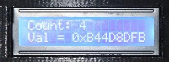

Load the IrTest sketch into the chord chart’s Arduino and apply power.
When the IrTest sketch starts, the LCD display should "Press a key.".
At this point it is waiting to see a key press from the IR remote control. Press any key on the IR remote. The LCD display will show the count of the number of IR key presses along with the hexadecimal code of the last pressed key. Something like the picture above should be displayed, with a count and value. For example: "Count: 4", "Val = 0xB44D8DFB".
Note that the 8-digit hex code should be unique for each key that is pressed. At this point, the value of the IR code is not important. The important thing is that the IR sensor recognized the receipt of an IR code, and that it is repeatable and unique for each unique IR remote key.
The sketch will continue to accept key presses and return their associated value forever.

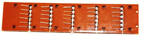

It is time to install the LEDs into the fingerboard. The 30 holes in the fingerboard are designed to snugly fit the 30 3mm LEDs. Each LED must be mounted with its longer lead toward the top of the fingerboard, and its shorter lead toward the bottom. It takes a moderate amount of force to install each LED. The best way to insert them is to hold the LED with needle nose pliers by one of leads. Now, with the LED oriented with the longer lead up, press the LED down into its corresponding fingerboard socket with enough force to get it to “snap” or “pop” into place. Be sure that all LEDs are seated to the same depth. This is best done by viewing the front of the fingerboard and verifying that all LEDs protrude the same distance.
Wire the LEDs
Note: The following steps require the LED leads to be bent. Use care when bending the LED leads. Bending them more than once or twice in the same spot may cause them to break off. Also, while bending the LED leads, be careful not to pull the LED out of its mounting hole in the fingerboard.
Bend the LED Leads
Proceed to bend the LED leads as shown in a photo above.
- Starting with the leftmost LED from the top fret, bend the top, longer, LED lead to the right so that it is parallel with the back of the fingerboard and touches the next LED to the right’s longer lead. The bend should be made close to the fingerboard, but not touching it (about 1/8” away). This will allow sufficient space so that soldering the leads, in a future step, will not melt the fingerboard, but will still provide enough room to mount the neck back.
- Repeat step 1 with the rest of the LEDs of the first fret, except the rightmost LED. Do not bend the rightmost LED’s longer lead. It will be handled in a later step.
- Repeat steps 1 and 2 on the rest of the fret LEDs, being sure to leave the rightmost LED lead unbent.
- Starting with the leftmost LED from the top fret, bend the bottom, shorter, LED lead down toward the corresponding LED of fret 2. Again, the bend should be made about 1/8” above the fingerboard.
- Repeat step 7 with the rest of the LEDs. The LED of the fifth fret should be bent down similar to all the other LEDs.
Solder the Fret (Horizontal) LEDs
- Starting with the leftmost LED of the top fret, solder the bent upper lead to the adjacent LED’s bent lead.
- Repeat step 1 for all LEDs in the top row except the rightmost. The LED to the left of the rightmost LED should be soldered to the unbent longer lead of the rightmost LED.
- Repeat steps 1 and 2 with the LED of all the remaining frets.
- Trim the LED lead from the next to last LED so that it does not protrude beyond the rightmost LED.
Wire the String (Vertical) LEDs
Note that it is recommended to use the solid wires for the string (vertical) LEDs. This should make it easier to perform the following steps. However, any kind of wire will do in a pinch.
- Cut a piece of yellow wire about 1 ½” long, and make a small loop on each end. The picture above shows an example in which black wire was used.
- Carefully slide the jumper wire from step 1 over the first LED leads of fret 1 and fret 2 (see the top right jumper of the picture above).
- Insure that the jumper is about half way over the bent leads of the two LEDs and solder both ends.
- Repeat steps 1 through 3 for all other connections as shown in the picture above. Note how the black and yellow wires in the picture are slightly bent away from the edges of the fingerboard. This is to allow room for the connection supports on the neck back, which will be added later.

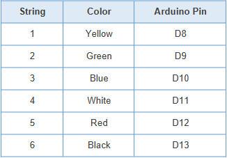

- Cut an 8” length of each color of stranded wire.
- Solder one end of the wires from step 1 to each of the corresponding colored fret 5 LEDs as shown in the picture. For example, the lower row of previously installed solid wires in the picture is yellow. Solder one end of the 8” wire from step 1 to the corresponding fret 5 LED lead.
- Repeat step 2 for each fret 5 LED lead (green, blue, white, red, black).
- Solder the other end of each of the wires from the preceding steps to a male 6-pin header, in the same order as the string LED wires (yellow, green, blue, white, red, black). See the wiring table picture above.

- Cut stranded wires as specified in the wiring table picture above table:
- Solder one end of each 1K ohm resistor to the LED lead that is unbent on each fret.
- Solder the wires that were cut in step 2 above to the other end of the resistors as specified in the table above.
- Solder the other end of each of the wires from the preceding step to a male 5-pin header, in the same order as the fret LED wires (yellow, green, blue, white, grey).
Check the LED Wiring
Visually inspect all connections for shorts and opens. Using the multimeter, check for shorts and opens. Shorts are most likely to occur on the header connections. Some voltmeters supply enough current in continuity mode to light an LED. If yours doesn’t do this, then a battery could be used in its place. A good test is to use the multimeter in continuity mode (or battery) to test the LED connections. While holding the black (common) probe on a string header pin, run the red (positive) probe over the fret header pins. You should see LEDs associated with the selected string light one-by-one down the frets. If any LED doesn’t light, then there is an open connection to that LED. If more than one LED lights up at a time, then there is a short. These conditions must be fixed before proceeding.
Test the LEDs
Plug the 5-pin fret header into pins A0-A4 of the Arduino, with the yellow wire associated with Arduino pin A0. Note that it might be necessary to file/sandpaper the 5-pin header and/or the 1 pin IR connector from Arduino pin A5. They might not mechanically fit in to the Arduino header socket without a little filing/sanding.
Plug the 6-pin string header into pins A8-A13 of the Arduino, with the yellow wire associated with Arduino pin A8.
Be sure that all the needed Arduino libraries have been installed as described earlier.
Load the GuitarChordChart sketch into the chord chart’s Arduino and apply power.
When the GuitarChordChart sketch starts, the LEDs should run a test cycle in which each LED successively turns on until all LEDs are lit, then the LEDs will successively turn off until all LEDs are unlit. Finally, the LEDs should light up in the pattern of a C major chord.
The LCD display should show "Chord-O-Matic", "V1.0 By JMC" as in the picture above until the LED test completes. Then the LCD should display the default chord: "C V:1 Fret: 1", "Major". This indicates a C Major chord, variation 1, starting on fret 1.

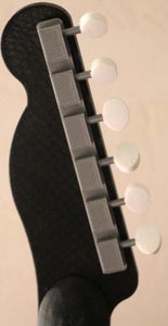

Step 9: Constructing the Neck and Headstock
Unplug the 6-pin string header and the 5-pin fret header from the Arduino.

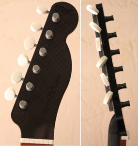

- Insert the 6 Tuner Posts into the Headstock. They must be inserted from the top of the Headstock (the side with the lettering). It may take a moderate amount of force to get the Tuner Posts seated properly into the Headstock. When properly seated, the flange on the Tuner Post should be flush with the top surface of the Headstock, and the Tuner Post should protrude from the bottom of the Headstock.
- Insert the 6 Tuner Shafts into the corresponding holes in the Tuner Assembly. A significant amount of force may be required to get the Tuner Shafts to insert into the Tuner Assembly.
- Attach the 6 Tuning Knobs to the ends of the 6 Tuner Shafts. A significant amount of force may be required to get the Tuning Knobs to seat correctly onto the Tuner Shafts.
- Attach the Tuner Assembly onto the end of the protruding Tuner Posts making sure that the holes for the Tuner Shafts face toward the near edge of the Headstock.
- Insert the 6 Tuner Shafts into the corresponding holes in the Tuner Assembly. A significant amount of force may be required to get the Tuner Shafts to insert into the Tuner Assembly. The Tuner Knobs should all end up at the same distance from the Tuner Assembly.
- Insert the Nut into the Fingerboard.
- Attach the Headstock to the Fingerboard.
- Insert the Mating Posts into the Fingerboard. Not all of the Mating Posts are necessary. I recommend inserting one at each of the corners, and at least one in the middle of each side (a total of at least 6). Note that a good deal of force may be needed to get the Mating Posts to seat properly into the Fingerboard.
- Align the Mating Posts with the Mating Post Holes in the Neck Back, and force the Neck Back onto the Mating Posts. The middle of the Neck Back will not support a lot of force, so it is best to apply pressure to the edges when getting the Neck Back and the Fingerboard to mate properly.

Modify IR Codes
There are 2 steps required to change the IR codes that the Guitar Chord Chart responds to.
- Determine the key code values of that are sent by the remote control that you are using. The Guitar Chord Chart uses the keys in the following table. If your remote control does not contain any of the specified keys, then you’ll need to find another key to substitute for it. The following table can be used to help gather the IR key codes for your remote control. Use the IrTest Arduino sketch to gather the equivalent key codes for your device, and enter them into the table below. Only keys that are used in the sketch are required. The others are displayed to show which keys may be used if you want to modify the existing functionality. The data from the table picture above is reproduced below. The data consists of "IR Key", "Sketch Name", "Used?", "Current Code", and "Your Code".
- POWER POWER NO 0xf124b0b6
