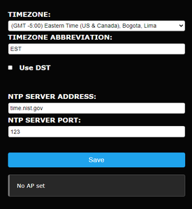

  • The third argument is optional, and specifies whether a separate 'Setup' button will appear on the WiFiTimeManager home page. If set to true, then a separate 'Setup' button will be displayed. If set to false, the timezone, DST, and NTP fields will reside below the WiFi credentials on the 'Configure WiFi' page. This argument defaults to a value of true.
// Initialize with our AP name and button selections.
pWtm->Init("AP_NAME", "AP_PASSWORD", true);
Finally, the WiFiTimeManager must connect to the WiFi via the autoConnect() method. The AP name and password that were supplied in the call to Init() are used.
// Attempt to connect with our AP name, and password (supplied via Init()).
pWtm->autoConnect();
With this minimal code, when the ESP32 starts it will try to connect to the WiFi. If it fails, it will start in Access Point (AP) mode. While in AP mode, its web page may be accessed via an IP address of 192.146.4.1. Selecting the 'Setup' button of the web page will allow the user to set timezone, DST, and NTP parameters for the local area. Selecting the 'Configure WiFi' button allows for setting credentials for the local WiFi network. The 'Setup' page should be updated and saved before the 'Configure WiFi' page since once the WiFi credentials are configured, AP mode is disabled.

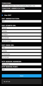

As shown above, WiFiTimeManager provides built-in parameters to specify the timezone, DST start and end, and NTP server address and port. This will be sufficient for most applications. However, WiFiTimeManager supplies an easy method for users to add user specified parameters as needed. The WebPages.h file contains the long NULL terminated string that is used to create the Setup page of the config portal. This string contains several comments at strategic points that may be used to insert HTML or JavaScript code. These points are:
  • "<!-- HTML START -->"
This marks the start of HTML, which is also the start of the web page string.
  • "<!-- HTML END -->"
This marks the end of HTML and is just before the end of the web page body.
  • "// JS START"
This marks the start of the JavaScript, just after the <script> declaration.
  • "// JS ONLOAD"
This marks a spot within the onload() JavaScript function where JavaScript initialization code can be added.
  • "// JS SAVE"
This marks a spot within the function that is executed when the submit (Save) button is pressed. It can be used to perform JavaScript save actions.
  • "// JS END"
This marks the end of of the JavaScript, just before the </script> declaration.
Two methods are used to support user parameters:
  • SetUpdateWebPageCallback() allows the user to set a callback that gets called when the Setup page is being updated. The called back function my insert code at any or all of the strategic comments listed above to support the new user parameter. See SetUpdateWebPageCallback() on the github page and the EditWebPage example for more information.
  • setSaveParamsCallback() allows the user to read the value(s) of any added parameter(s). The called back function is invoked after the user clicks the Save button of the Setup page. See setSaveParamsCallback() on the github page and the EditWebPage example for more information.
