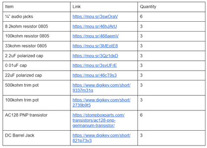

Here are the components that we used for this initial design:
At the end, we will talk about what we would change in future iterations (hint: pick your item footprints very carefully!).
