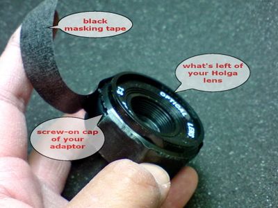

Step 16: Tape the Lens to the Screw-on Nut
Tape the Holga lens on to the screw-on adaptor nut. And when taking macro pictures of your finger, always apply generous amount of lotion...
Step 17: Attach Lens Cap
Attach lens cap. Remove excess tape so it snugs on.

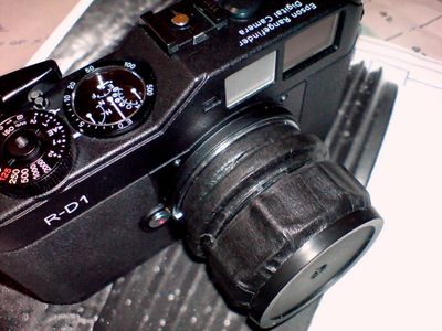

Step 20: Tah-Dah
Done!
Step 21: Instruction on Focusing
After testing the lens, I happy to report it actually works!
With the lens screwed on tight (but not too tight), we can get focus from infinite to about 15'.
With the lens barely hanging on at the last spiral (not falling off), it can get as close as 1.5'.
Experiment with it, and refer to the picture for more info. Lastly, drop me a line here or email to tell me how you like it.
Step 22: Sample Picture #1
You can shoot without the cap.
Step 23: Sample Picture #2
Or, you can shoot with the cap on for the classical Holga 6x6 look.
