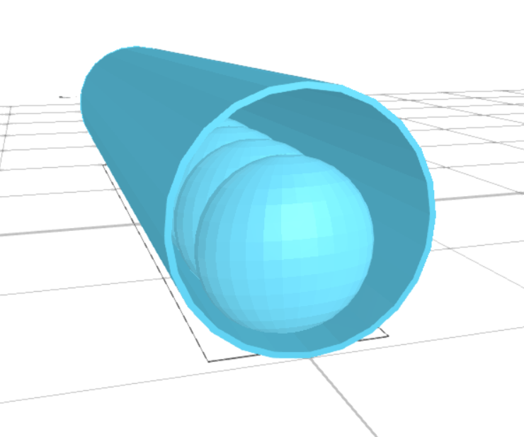

Step 1: Insert a Cylinder and Delete Its Circular Faces
First of all, go to the 3D shapes and insert a cylinder to the working interface. Set its height to 5, vertical segments to 50, and rotation x to 90. Then opt for polygon selection and select both the circular faces of the cylinder and delete them.
Step 2: Add Thickness to the Object and Activate Loop Selection
Next from the modify category, select the add thickness tool. Set thickness to 1. Then opt for edge selection, go to settings and activate the loop selection.
Step 3: Fillet the Circular Edges
Now, select both the circular edges. Then from the modify category, select the fillet tool. Set intensity to 0.5 and level to 4.
Step 4: Copy the Selected Object
Next, go to the tools category and select the copy offsets option. Set y to 2. Then click on the add option to add a new macro step. Set operation to rotate, y to 6.6 and amount of copies to 26. After that, click on the create copy button to create copies.
Step 5: Insert a Cylinder and Select All the Objects
Now, we will insert a cylinder and set its top radius to 2, bottom radius to 2, height to 152 and position y to 1. Then go to the edit menu and select all the objects.
Step 6: Make the Selection a Union
Next, go to stitch and scoop and make them a union.
Step 7: CONCLUSION: HENCE, WE HAVE DESIGNED a 3D DESIGN FORM IN SelfCAD
The design form was successfully 3D constructed in SelfCAD. This course combines important features like move, and 3D shapes in addition to the core SelfCAD tools like edge selection and copy offsets. As there are no arithmetic errors that could make configurations difficult to print, all of the 3D models created in SelfCAD are 3D printable.
