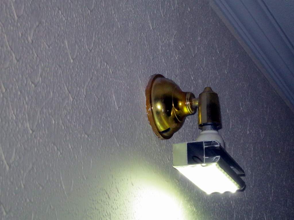

HV9910 is universal LED driver used for driving string(s) of LEDs from wide range of input voltages (8v to 450v DC). Providing constant current on the output for driving different watts of LED string(s). I have taken help of data sheet of HV9910 , documentation of demo board 2 (file attached) of HV9910 and Application note AN-H48.
There are lot of information available in the above mentioned links and files about HV9910.
I have made this circuit by using different values of the components (See attached Excel file) to provide an out put of 35 to 40 volts DC and 1 Amp current.
One more different thing in this project is the use of two inductors in series for getting required output because I was not able to find one inductor of the required value from my local electronics markets. For this purpose I took help of a field engineer from Supertex and was successful in using two identical inductors of the same value in series to get required output.
