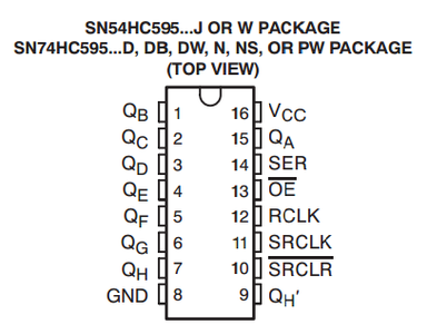

In order to display the correct pattern of LEDs to mimic a letter in "Happy Halloween", I took advantage of using 8-bit SIPO shift registers. These ICs allow me to give them an 8 bit input and have the 8 bits be individually displayed on the 8 outputs.
Knowing this, you can assign the pairs of LEDs in the "top" and "bottom" half of the 16-segment display to individual outputs on the two shift registers. After making these connections, I figured out what pairs of LEDs would need to be lit up in order to display the desired letter and determined the 8 bit binary (and subsequently decimal value) I would need to send to the two shift registers for each letter.
In terms of connecting to the microcontroller, I connected the SER, RCLK, SRCLK, and SRCLR (with the over-bar) to digital pins on the microcontroller. Personally, I used digital pins 34, 36, 38, and 40, respectively, for the shift register attached to the top half of the 16-segment display and pins 26, 28, 30, and 32 for the shift register associated with the bottom half of the 16-segment display.
The Vcc of both shift registers was attached to a 5V rail and both the GND and OE (with the over-bar) were attached to a ground rail. 5V was used instead of 3.3V because two LEDs are to receive a signal from each output, and the combined voltage drop across the two LEDs is above 3.3V (so the LEDs would not light up) but below 5V.
