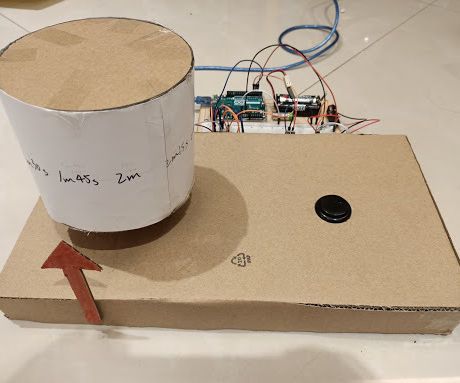

Step 4: Create the Elevator Pulley & Combine
  1. Cut 2 segments of straw with the same length (5~7 cm)
  2. Stick the straw segments onto the two axis of the motor
  3. Create 4 circles with cardboard; drill a hole at the center
  4. Cut 2 segments of thick straw with the same length (2~3 cm)
  5. Stick the circles and the straw onto the axis as shown in pic 3
  6. Stick the strings to the thick straw axis (through the top layer of the elevator tower)
  7. Add extra cardboard parts to the side of the elevator shaft as track for the elevator (prevent wobbling)
Step 5: Connect the Arduino
  1. Connect the electronic parts as shown in the image
  2. Place the finished Arduino set into another cardboard box
  3. Connect the box with the main structure
