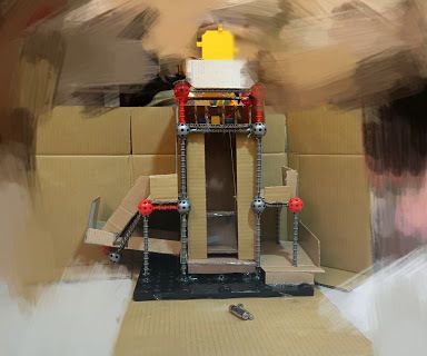

This project, the Instant Noodle Timer, is designed to time for making instant noodles. The timer will begin the 3 minutes count-up when the button is pressed, which may be activated when placing the noodle bowl on to the button. The time will be indicated with the spot which the arrow points to, while the wheel will turn every 15 seconds.

Step 3: Creating Mechanical Part
Creating Base
  • Create a rectangle box with the cardboard as the base
  • Leave the bottom of the box open in case any adjustment needs to be make
  • Drill to holes at one side of the box to let the wires of button and motor to go through
  • Cut two circular holes to hold the button and the motor (large enough to place it but not too large to let it drop; if the hole is too large, stick the button/motor to the box)
Creating Wheel/Clock
  • Create two circles with card board (same size)
  • Drill a hole at the center of one piece (the size of the motor axis)
  • Create the surface of the timer with hard paper
  • Divide the circumference distance of the circle into 12 sections, than write the number according to the sections (+15 seconds, +15 seconds...)
  • Connect the paper with the circle card boards
Creating the Arrow/Needle
  • Cut the arrow out from cardboard
Step 4: Combining the Parts
  • Place the button and the motor into the holes
  • Put the wires of the button and the motor through the side holes, attach back to the breadboard
  • Stick the wheel to the axis of the motor
*Make sure that the wheel is tight and stable on the motor axis
*Be careful if using hot melt adhesive
