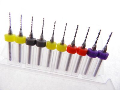

After trimming both posts to size we need to make a hole on each side to push the copper wire through.
Amazon - PCB Drill set
I always use these PCB drill sets when making jewellery, they are super sharp, fits in a Dremel and cheap when you buy in bulk (which is a must because they break easily)
Drill a 1mm (depending on your copper wire thickness) hole in the middle on each side about 0.5-1mm from the top.

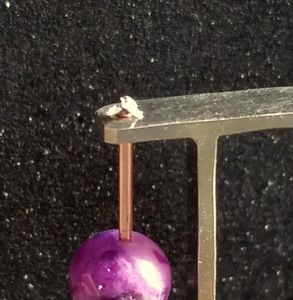

Step 7: Soldering Part 2:
We are now going to solder the copper wire into place.
Feed the copper wire through both holes with the beads in place between the posts, make sure the wire piece is perfectly straight and then hold it in place at the bottom using pliers.
TIP: Grab yourself some surgical pliers like these Amazon - Surgical pliers they are high quality stainless steel self locking pliers that can take the heat when soldering.
Snip off the excess wire on top, add a tiny amount of flux and a small piece of solder on top of the wire you just cut as pictured.
Because this is such a tiny piece without much mechanical stresses and I didn't want to apply a lot of heat to the beads I decided to use a tin solder to do this step.
With your butane torch and a low flame gently heat up the joint until the solder flows in around the wire.
Flip it over and repeat on the other side.
Leave the piece to cool completely.
