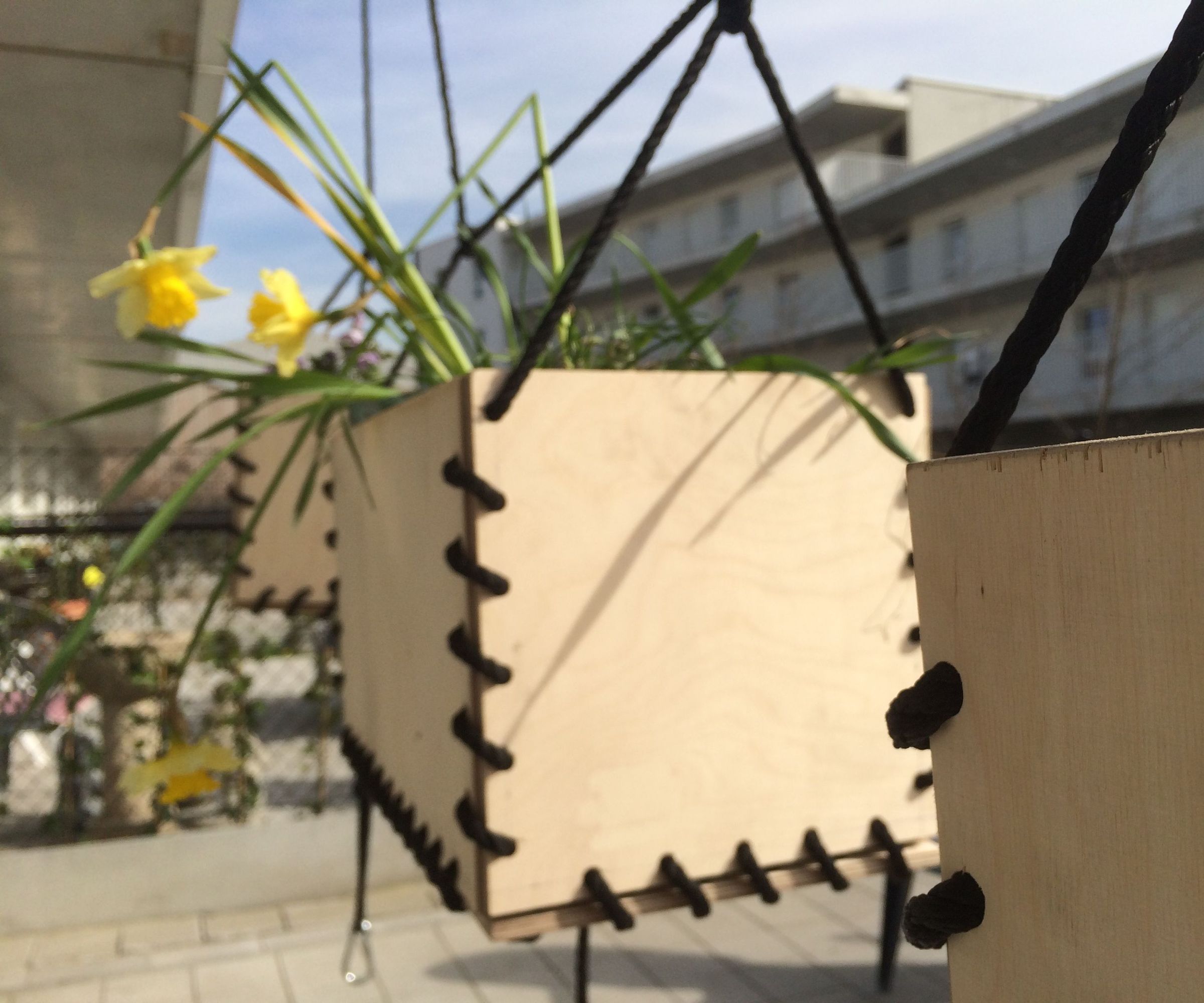

Step 1: Planter Crates
We used these crates we made earlier HERE.
The connection, the holders, as well the hanging system are completely made of rope, providing a uniform design.

what is that blue thing in the step 1 pic! :)
Reply 8 years ago on Introduction
Hey, thanks :)
Oh, it's just a giant blue plastic crocodile with a giant blue bottle strapped around it's waist. Nothing special.
