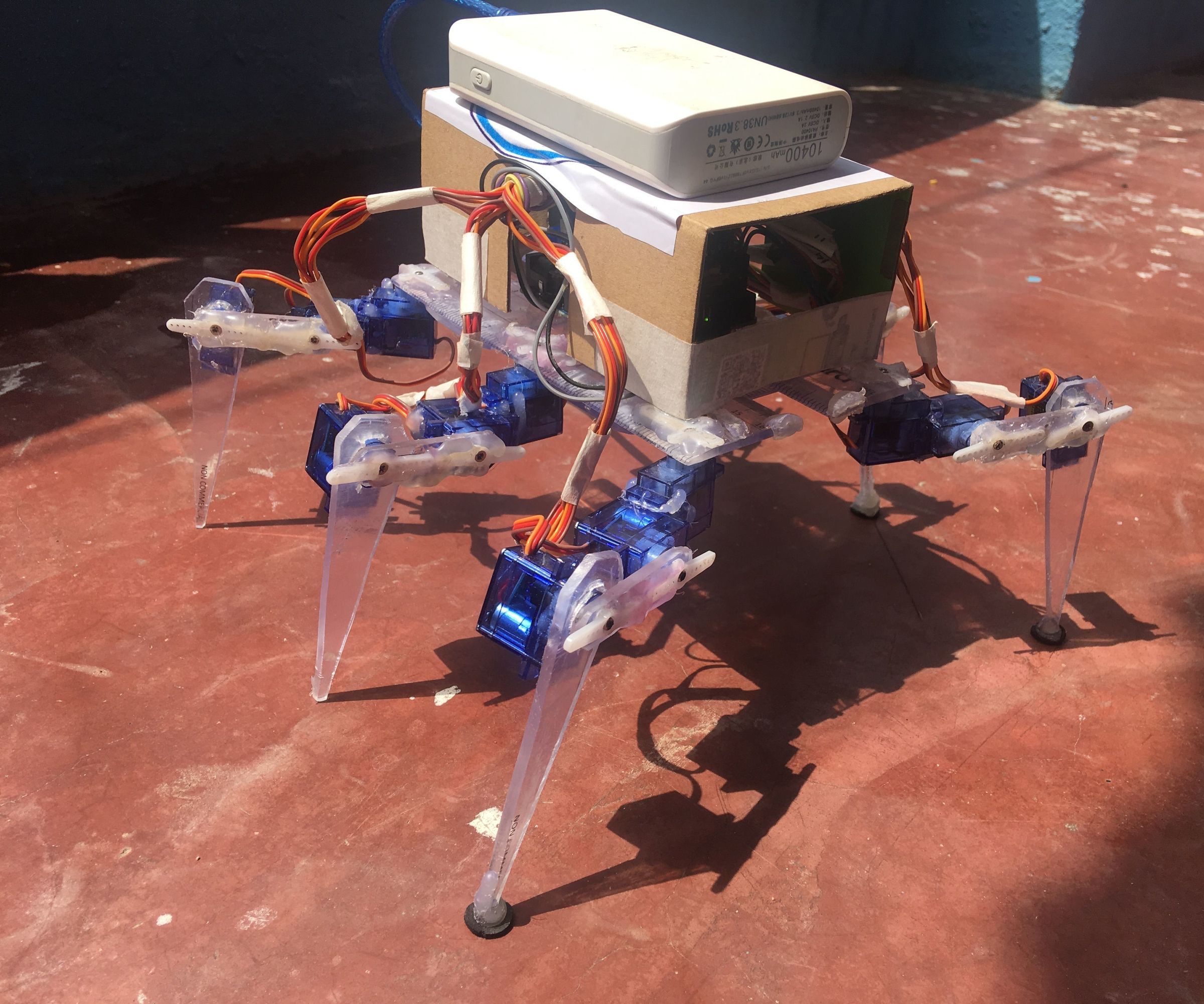

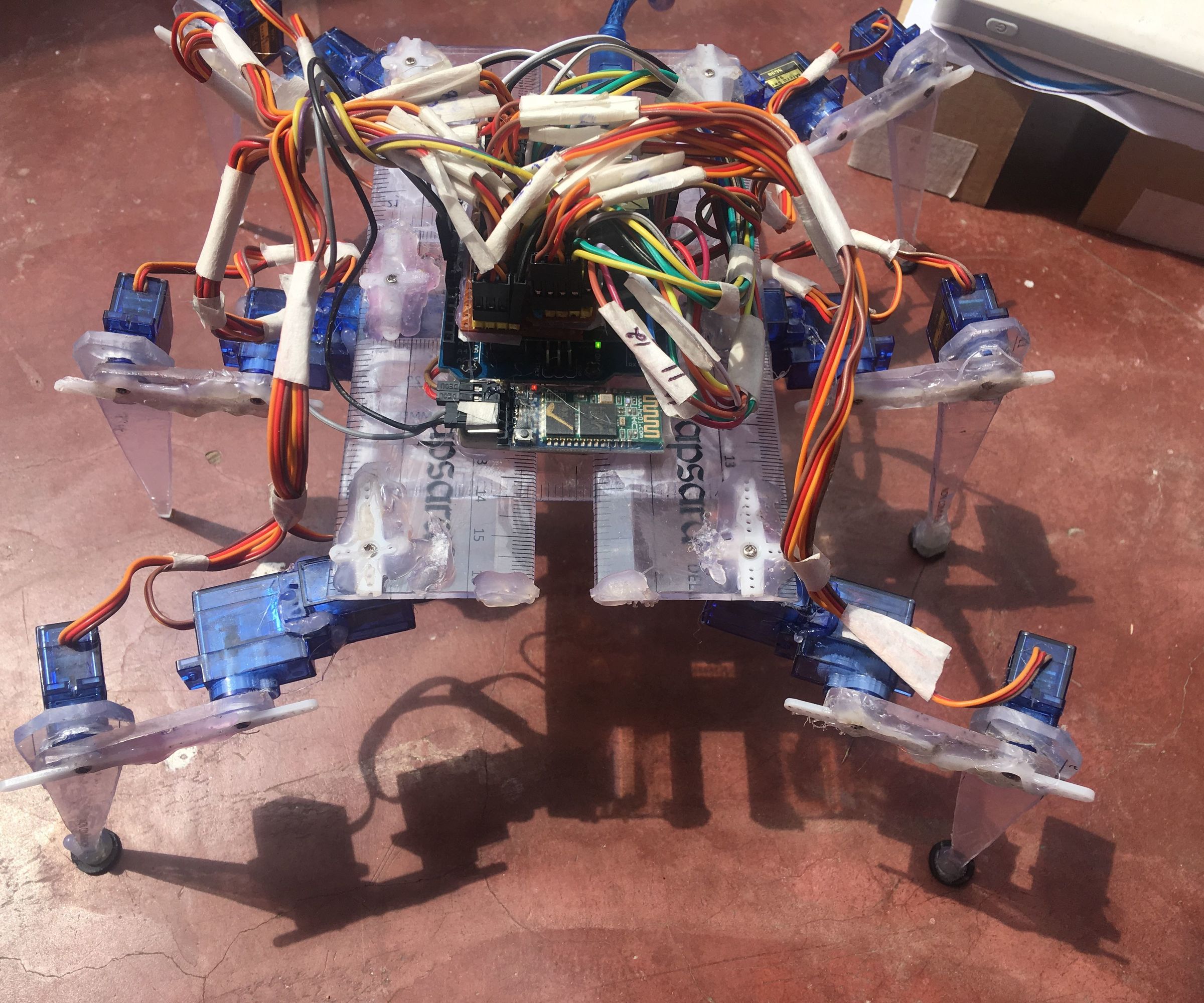

The design used for the body of the hexapod is rectangular .Rectangular body shape with six leg having three degree of freedom of each leg is its speciality. This design replicate the dynamic movement of the six-leg insects.The Hexapod design is the upgraded version of the my previous project hexapod (instructables.com/id/HEXAPOD-2/) which i had made early 2 years ago with the help of the plastic ruler.within these two years of time as i am a engineering student i had learn to use different program and software. (such as proteus and CAD) which helps me to make this hexapod up to this. I upgrade this hexapod from the first to this one replacing all the body parts .

For the wiring of the hexapod i have design the circuit diagram on the proteus and develop the circuit on the pvc matrix board as shown in photos. The connection of the servo motor are common like as
servo motor (1-7)
servo motor (2-3)
servo motor(5-6)
servo motor(8-9)
servo motor(11-12)
servo motor(14-15)
servo motor(17-18)
Servo motor(10-16)
Step 4: Assembling and Simulation on the Cad
Now let see the simulation of the legs of the hexapod how it get the three degree of freedom.
The most consuming time of the project is to design the 3d modules of the different parts and printing them as well as simulating the circuits.
The most common technical problem occurred this project at first is power management & weight management for to overcome power-supply problem , the supply of the power to the servomotor i have directly connect the jumper from below the Arduino port A/B. And also taken 5v dc supply from the Arduino board by which the currant supply get increased by remaining 5v supply by which i get the benefits like as my hexapod can be operate using any ordinary mobile charger , power-bank or usb port of the laptop. And for the maintain weight and centre of gravity uniformly even when its legs get up in the air i have program the hexapod in such a way that it replicated the movement of six leg insects . First three legs get rise and move then they land and after that remaining another three legs get up and move then land by which all the weight get on the centre of the body.

I had upgrade this hexapod from the my first hexapod to this as shown in picture , which i have done using different knowledge acquired from my engineering courses as well as through the help of the different post related to hexapod on this site instructables.com
