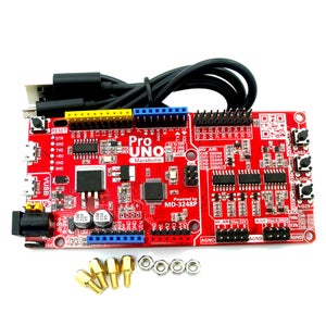

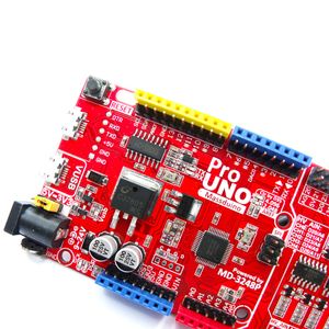

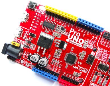

Introduction: High Performance Enhanced Development Board Compatible With Arduino UNO
ü Full resource of UNO R3
ü Onboard Virtual USB HID device n The USB HID can be programming the board as a keyboard / mice / etc… with HID class device
ü Ground test terminal ü TQFP-48 MD-3248P MCU
ü Analog power and digital power and ground are separated
ü Onboard 4.096V/2.048V voltage reference source n 4.096V for PWM-DAC n AREF for MCU ADC selectable between 4.096V and 2.048V
ü 4 channel onboard PWM-DAC n CH0/1 with 16bit resolution n CH2/3 with 12bit resolution
ü 5 channel High Voltage Analog input n Range 32V with 4.096V AREF n Range 16V with 2.048V AREF
ü Onboard 3 tack switch buttons and 3 LEDs for fast programming
Step 1: Features & Parameters
Massduino MD-3248P with 32KB Flash , 2KB SRAM
○ Fully Arduino IDE development
○ Full arduino UNO resource support
○ Rich additional resource
3 user programmable LEDs
4 CH pwm DAC (2 ch fast mode and 2 ch high resolution mode)
5 CH HV ADC (Max input 32V)
Onboard 4.096V and 2.048V voltage reference source
○ Virtual USB , make the board as a HID device (Keyboard / Mice etc.)
○ DC input voltage : DC 9 to 24V
○ System voltage : 3.3V or 5V ○ PWM DAC Range : 0 ~ 4.096V ○ PWM Resolution (CH 1/2): 16bit ○ PWM Resolution ( CH 3/4): 10bit ○ HV ADC input range: 0~32V ○ HV ADC resolution: 1mV w/s 15bit ADC (analogRead_15bits())
