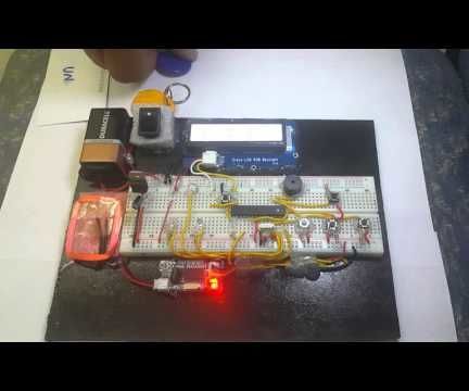

Step 2: Transmitter Circuit on Breadboard
Step 3: Transmitter Circuit Diagram
Transmitter: It consists of micro-controller interfaced with RF transmitter. The user will provide the commands such as BULB ON/OFF, FAN ON/OFF and DOOR OPEN/CLOSE using push buttons. Each button is marked with a label showing its intended function. Upon data transmission, an LED indicator will blink showing that the data is successfully transmitted to the receiver.

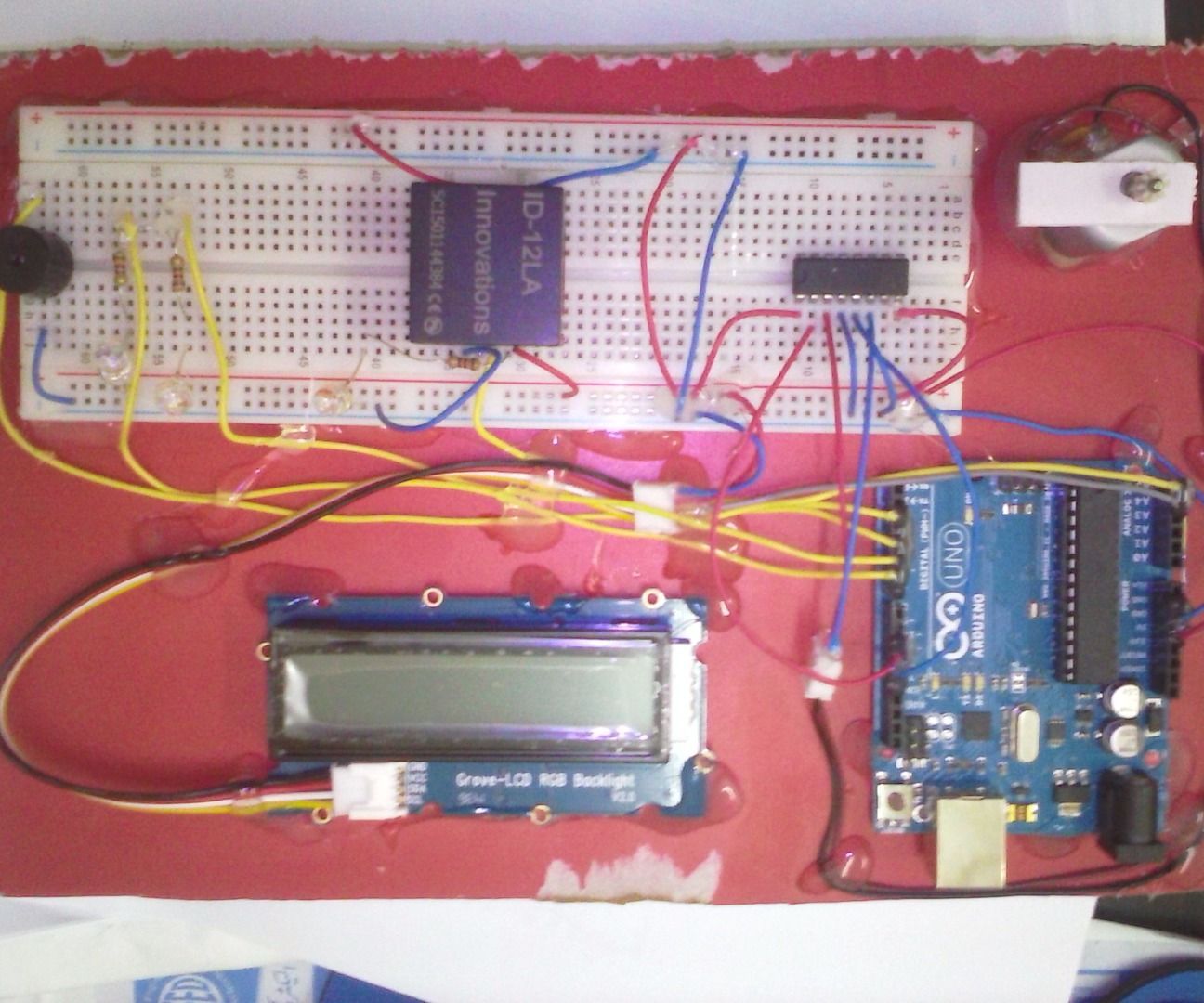

Step 5: Receiver Bread Board Design
Step 6: Receiver Circuit Diagram
Receiver: It will consist of micro-controller and the RF receiver. There will be only one receiver in this project. Upon message reception from the transmitter, micro-controller will be programmed to first check the accuracy or integrity of data. Once valid, micro-controller will check the message. If the message corresponds to respective function, then a proper actuator will be initialized to perform that particular action. The receiver consists of LED bulbs, FAN and the DC motor for opening and closing the door.
