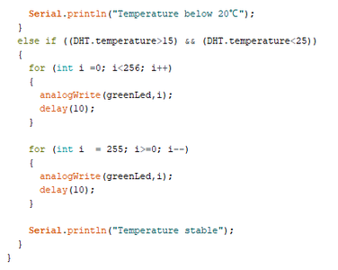

Step 6: Functions
As you can see in the screenshot above, I have 2 functions in my code, void displayTemp and void led.
DHT.temperature and DHT.humidity are important parts of both functions, as it's what is used to store the temperature in Celsius and the humidity %.
  • Void displayTemp
void displayTemp is the main function, with it's purpose being to get the temperature and humidity from the Humiture sensor, and print it everything that is on the LCD. This includes; "Tem:", "Hum", the signs for Celsius and percentage, and the actual temperature and humidity that it gets from DHT.temperature and DHT.humidity.
  • Void led
void LED, as you may have guessed, contains the code for the LEDs, controlling when they turn on and the blinking of the LED. As you can see in the screenshot, I used if and else if statements to dictate which LED should be on depending on the temperature and print on the serial monitor whether it's too hot, too cold, or stable temperature. I coded it so that if the temperature is 20°C or higher, the red LED blinks, if the temperature is between 20°C and 25°C, the green LED blinks, and if the temperature is 20°C or below, the blue LED turns on.

  • Writing DHT.temperature wrong, causing LEDs to not work
If you look at the void displayTemp function, you would see that there's a 1 at the end of DHT.temperature, written as DHT.temperature,1. I thought the 1 was supposed to be there in every situation, but it turned out that it was just for the LCD, and you were not supposed to include it in the if statements for the LEDs. I wasn't able to spot this issue as this was my first time using these coding statements and these components, but my teacher was able to find this issue to fix my problem with the LEDs.
