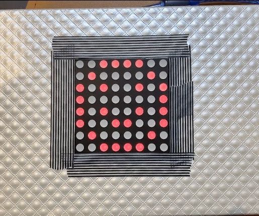

This project can help remind your family that you're home if they are busy with housework or other stuff. The reason why I create this reminder is that every day when I go home from school, my mom is usually cooking and she couldn't hear that I'm back home, so I design this home reminder to remind my mom that I'm home. The planet will light on when the photoresist senses me back home and it will convey to the LED lights then make the planet lighting.

Use scissors or tool that is sharp to cut out the box so that the USB cable and those wires can connect the computer and your device together and work out smoothly. Also cut a big circle or square to let the LED light through the balls and make it become protruding.
Step 5: Decorate the Box and Test the Reminder
Find a box that fits your Arduino and decorate it with your planet-like ball and put it at places where your family can see it and also places that you will go through every day. Then you're finished, Congratulations.
