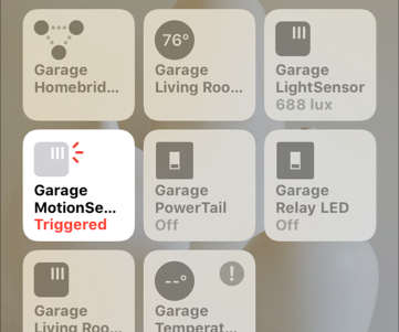

Step 6: Test the New Accessory in IOS HomeKit App
Test the new Accessory in iOS HomeKit App and Siri
