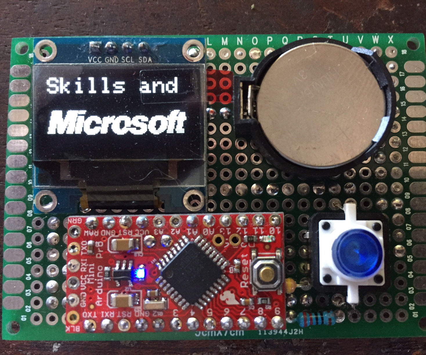

Pictured above is a sample connection of the motion sensor and a NodeMCU. We want to use a different pin than pictured above (or change the Arduino IDE code). see below.
Pictured above is a few sensors I have made with the addition of a photocell and potientiometer to adjust the light sensor sensitivity. Also pictured is an optional DS18B20 temperature sensor module. See my other Instructables if you are interested in adding the other sensors.
HC-SR501 data pin goes to NodeMCU D4 pin. check the sample Arduino code to make sure it matches the pin used in the code. For the older code, NodeMCU Digital Pin 1, set the Arduino Code to "int pirpin = 5" . This is because the NodeMCU pins map out to different GPIO#'s in reality. Google Images search "nodemcu pinout" to see a chart with the correct PIN to GPIO mappings.
USB cable +5 & HC-SR501 VCC goes to NodeMCU Vin pin
USB cable -GND & HC-SR501 GND goes to NodeMCU GND
Photocell to A0

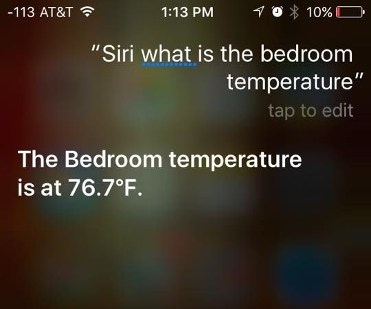

Step 6: Test the New Accessory in IOS HomeKit App
Test the new Accessory in iOS HomeKit App
Test the new Accessory in iOS HomeKit App and Siri
