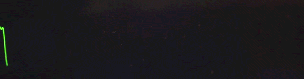

![](https://content.instructables.com/FW6/5ROU/HU843UGM/FW65ROUHU843UGM.gif?auto=webp&fit=bounds&frame=0&height=1024&width=1024)
Let me clarify this to you. This project works and can actually monitor your pulse. Due to the lack of research and experimentation, the homebrew pulse monitor cannot be used for medical purposes.

Step 10: The Codes
Run these codes on the proper IDE. If the processing 2 codes shows an error, change tho port number (found in the codes).

Step 11: Learn to Use It!
Make Magazine has a similar project that works exactly the same. I got the codes from them so video should explain the programming procedure.
